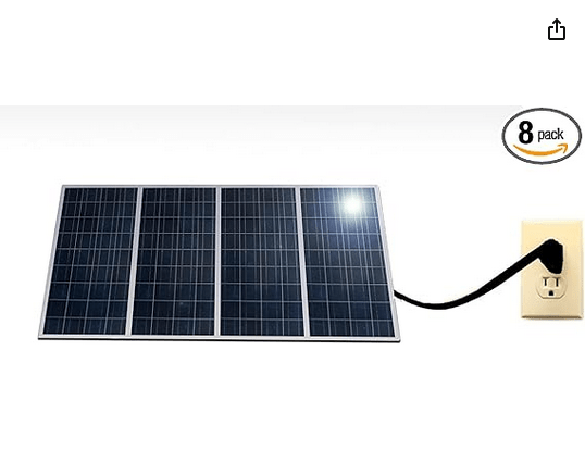

Update following this morning's meeting. First order of business will be to replace the meter and test the one removed. Meter Foreman will be voltage testing the load side meter base lugs when the meter is out. The area looks more rural, but I have no information on the water service or lot size.
Any thoughts on this?
Laughing Out Loud!
That definitely has back feed capability.
If you take time to read the specs:
"No Batteries." vs "Power Source, Battery Powered"
"Includes 4PCS of 160 Watt Solar Panels (total 640Watt)," vs "Maximum Power ‎320 Watts"
They claim anti-islanding protection, maybe.
Anti back-feed is very difficult without monitoring the draw from the utility, which this does not do.
