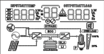

Searching pulls up some manuals, one of which contained the panel diagram below.
This Hybrid Inverter (probably most) is designed to sit between the grid and the user, all of the power flows through the inverter, unless the inverter is bypassed (bypass mode). The inverters probably can not be paralleled unless specifically designed for that operating mode.
The inverter controller manages the grid connection, and the battery charging.

Distributed energy inverters and battery power converters provide the sync check internally - they sense the AC voltage, frequency, and phase on both sides of their AC contactor and they modulate their output to match the line side before closing. That's why they won't return to operation in grid-following mode unless they see an AC source on the line side of their AC contactor. There's usually a delay built into their reconnection to ensure the grid is stable - many manufacturers use a default of five minutes, but it can go as high as ten minutes, so there's plenty of time to sync. However, the sync can happen very fast once they decide to do it; it just takes a few cycles since all they have to do is modulate the switching.
