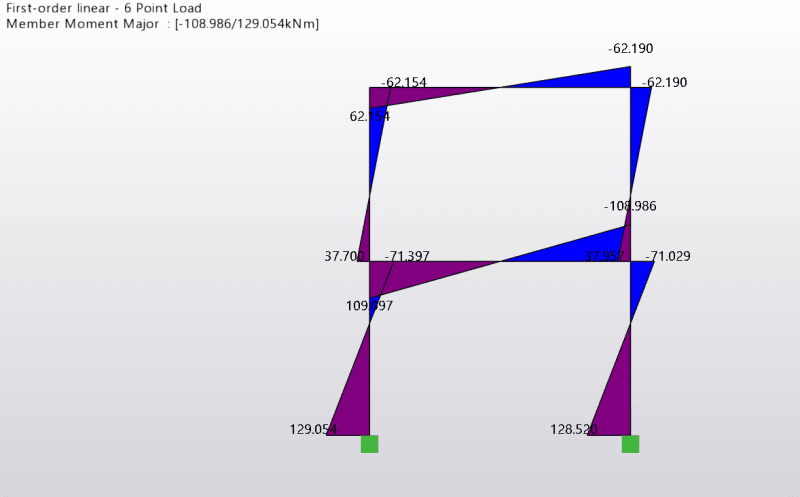

Here are the bending moment on the structure:
You might not be able to see, but for the columns, you get a positive bending moment at the bottom of each storey and a negative bending moment at the top of the storey - this pattern is the same for each storey.
In my code I am getting positive bending moments at the top and the bottom, but like I said the magnitude is quite accurate.

I'm confused by the FEM output. At the top LH corner things appear to balance ... +1.968 and -1.968 balance, and red and blue also balance. But 1/2 way we have (red) 4.326 from the column and 5.408 from the horizontal and (blue) +9.734 ... doesn't balance ??
rather than looking at a big multi-story frame, try modeling just a single frame that will make it easier to troubleshoot your code.
You could go even simpler and just model a fixed-fixed vertical column and enforce a rotation at the top.
Yes, I just checked, and that is very strange. The signs appear incorrect. You need -4.325 to balance, but its positive giving an unblanced moment of 8.651 kNm. The software is Tekla Structural Designer (student version).

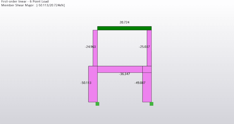

Here, is the model in Tekla:
Compare the table in the code to Tekla and you can see differencves in sign.

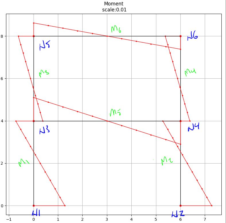

your results are accurate, the member local end results are the results applied to the end of the member. The internal member moment may have the opposite sign.
It appears Tekla may also be using a different sign convention. Here are the results I get:

Thanks for taking the time to go through the problem, Celt83!

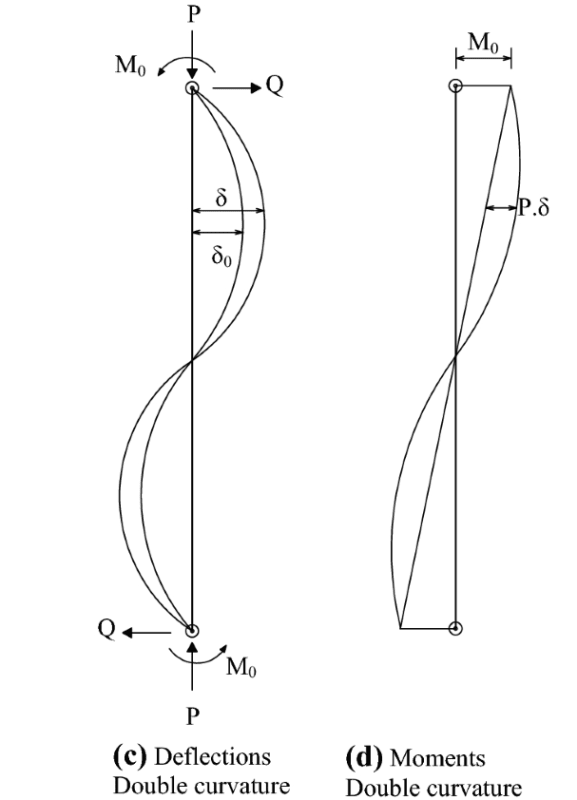

However, you are getting the same results as me. Considering member 1, both your moments are positive (like mine). How is this? A 2D structure under a lateral load causes the columns and beams to bend in double curvature and produce the corrosponding BM diagram.
Thus, the sign of the moment at the bottom changes when it passes the point of contraflexure. I am puzzled why we are not getting this.
Refer to your left diagram the applied end moments are Mo and both are in the same direction (the same sign). The direct stiffness results are the applied moments to the end of the member the internal moment, the plotted moment diagram from tekla, comes from the application of statics/mechanics along the length of the member.
Ah right, so that was the problem. Thanks
I wouldn't necessarily call it a problem, it is more just understanding that the direct stiffness method is all about the joints and the data that you get out of it is the joint displacements and joint forces. You need to then post-process the joint data to get at the internal member data, the commercial software does the post-process black box so all you get out of it usually are the internal member values (understanding the software packages sign conventions is also critical).
You were focused on just the moments, but if you look at your local member shears and axial forces you'll see they swap sign however the internal member response will be a constant shear and axial force.
