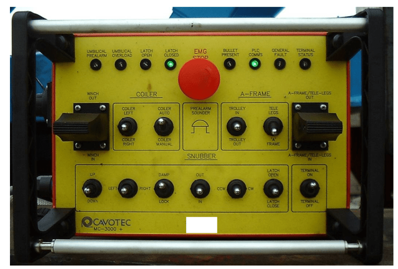

after cross check with the remote control, I understand more on what you said.
FluidPowerUser said:
The valves on the left control the extend and retract of the damping cylinder. The idea being that the recovered item, boat or buoy or whatever, is pulled up against the damper. Or, it is offering some controlled "docking" when the assembly is luffed.
The valve on the right, when not operated, will make the damper rigid. When the valve on the right is operated, it makes a primitive regen circuit and connects the rod of the damper cylinder to the head. The flow control valves limit the flow of the oil through the circuit and control the amount of damping.
that means in order to provide the damper (or slowing down the motion), I need to activate the solenoid valve when operating the 'snubber in/out'.
Thank you for that.
R.Efendy
Snubbing switch will move the cylinder in and out
Damp/lock will do as it says. Either dampen the operation or lock the cylinder.
The valves will operate independently of each other. In other words, one will operate the direction and one will turn on the damping, you don't need to operate them at the same time.
