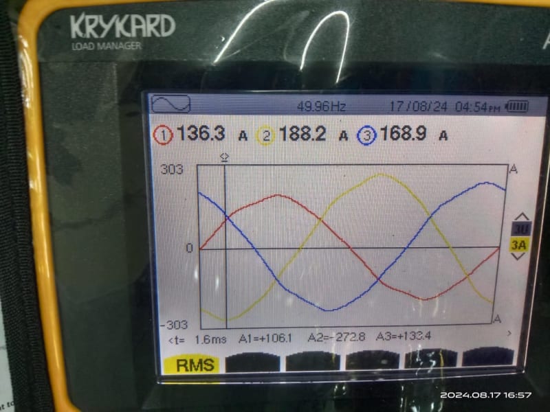

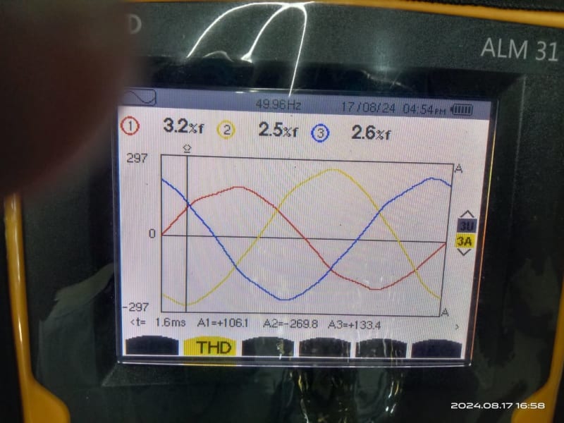

In this case THD is 2.7% and difference in neutral current is >50%. There should be some other issue.
3 phase input RMS current waveform.
3 phase input THD current waveform
Do you see much of a phase angle difference here?

Note that B peaks considerably after the crossing of R&Y. This would occur if the angles of R&Y were 0 and -120, and the angle of B was 100 deg.
Try moving the cursor on the meter to determine the zero crossing times of the three currents.

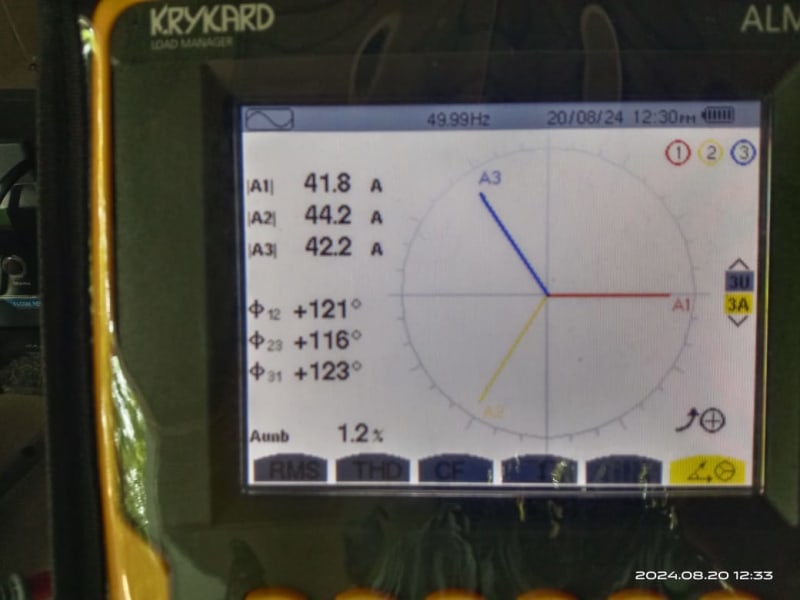

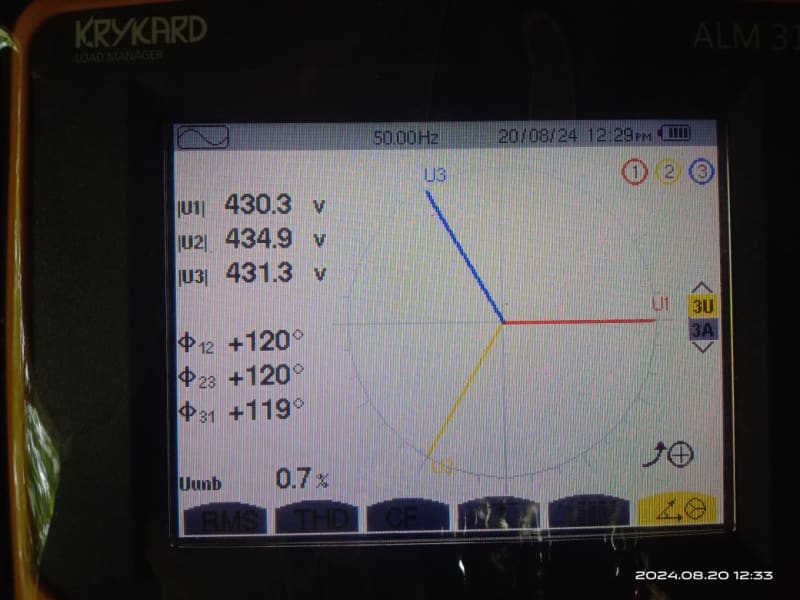

Current phasor (low load)
Voltage phasor (low load

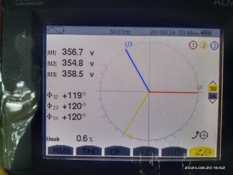

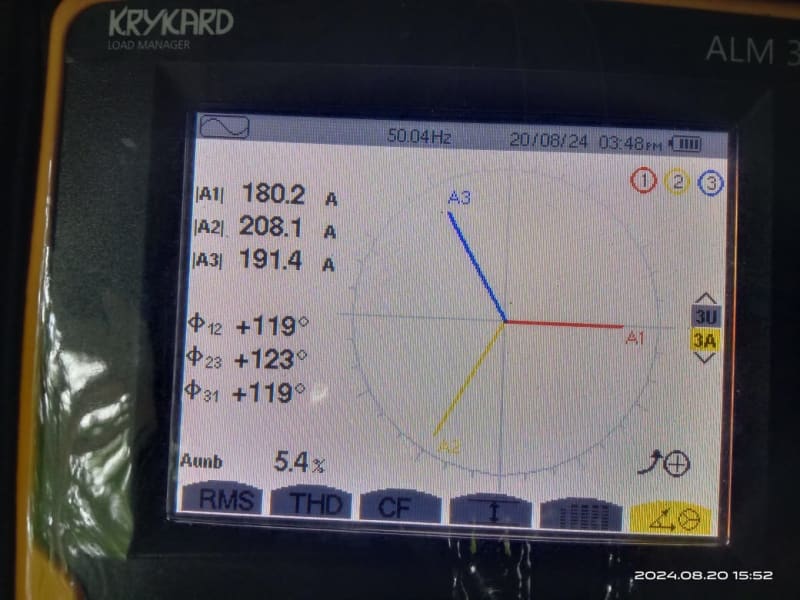

Current phasor with full load
Voltage phasor with full load (75 to 80 V drop in voltage with full load. Utility has been informed about poor regulation)
3 phase current THD on full load (not much)
Measured neutral current 16 Amps with Fluke clamp-on.
