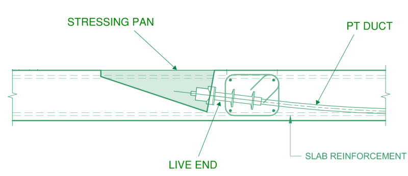

Please define "pan stressing". (I'm not familiar with that term.)
It is a temporary partial-depth blockout/recess consisting of a (typically) plastic form pan to enable internal stressing without a full-depth slab penetration. Commonly used in BONDED PT slab systems. A curved stressing nose if often required to angle the stressing jack to clear the angled slab recess.
BacBac:
I avoid pans where possible. Elongations typically come out less than anticipated, chance of breaking wires/strands during stressing, and they need to be detailed correctly otherwise cracking occurs due to the PT force difference from one side to the other side of the internal anchorage.
Edge stressing, whilst preferred, are sometime problematic due to access or the finishes. If the edge pockets are to be blended in with the adjacent concrete, typically the slab edge would be 'cement washed' then painted, but under critical light sometime the PT pockets can still be seen. Need to work with the architect and builder.
Both are common. There are no rules stating when you may use pans. You need to work with the rest of the team.

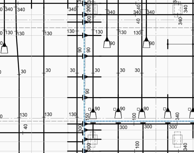

Regarding stressing "at" joints, I've seen both where it's edge and pan stressing.
In engineering point of view, I'd have thought edge stressing would be better as it reduces congestion.
In the end, I think this needs to be communicated with the builder for them to consider in their sequences.
See snapshot below, blue dashed lines are the Construction Joints (CJ).
*edited "through" to "at"
BacBac,
Live ends, dead ends at construction joint. What supports the side with the dead ends?
Regarding stressing through joints, I've seen both where it's edge and pan stressing.
I think what JSN was getting at is that the PT tendons stop and start each side of the CJ. The tendons do not pass "through" the joint.

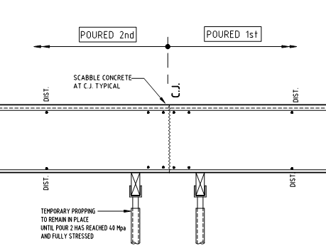

hokie66:
There's top and btm bars continuous through the construction joint to maintain moment continuity.
I believe the props would stay until both pour reaches its strength.
Retrograde:
Apologies for my bad wording. Not meant to have tendons pass through the CJ as it'll start-stop.
The question is more to the feasibility to stress the tendons at the CJ with edge stressing.
There may be some regional difference on what is a ‘construction joint’.
My definition of a CJ is a temporary joint usually used at the convenience of the contractor as opposed to a permanent joint defined by the engineer of record on the structural drawings.
It would be very unusual to have top and bottom rebar continuous through a CJ for moment continuity withOUT also having the PT continuous through the joint. With continuous rebar through the joint why don’t you use intermediate coupling anchorages at the CJ, assuming this is not a permanent joint?
Ingenuity
True, in that particular snapshot, the construction joint is a "pour joint" as the builder cannot pour the whole slab in 1 pour. Some people call these bars as "stitching bars"
Typical detail is as per snapshot below.

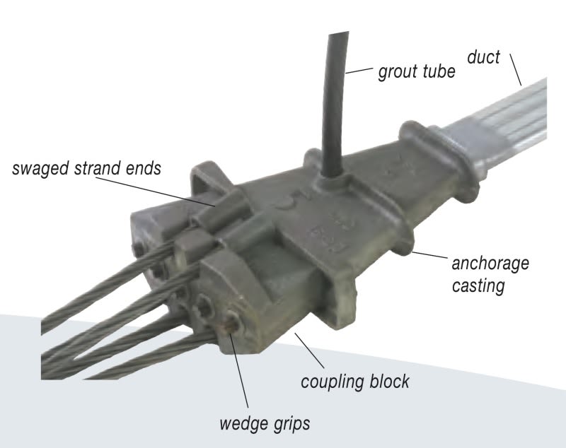

Did you mean intermediate coupling anchorages for the tendons?
I have been told to avoid these tendon couplers as there have been past safety issues with them not installed correctly or some sort.
I have not seen these couplers details used lately here.
BacBac:
For a CJ that is part of a 'pour joint' we usually have the width of the joint to be about 4 feet (1200 mm) - or more - so you can accommodate slab edge stressing and avoid pan stressing.
I have not practiced in AU for many years, but back in the day we used coupled CJ anchors all the time. But that was when PT on site was conducted by experienced installers. I am going to guess that some swages at the coupled joint slipped and caused an accident that now prevents their use. Never had any problems with couplers when I was doing bonded PT.

Regardless of whether you use couplers or stitching bars, I wouldn't position construction joints where shown. Along or close to a column centre line is no place for a construction joint. Provide them near centre span, or within the central half span. Ingenuity is probably right about the PT industry. I have seen couplers used many times. If you do use them, another reason not to locate CJ's on the column line (or right at centre span) is that additional clearance is required for the couplers.
