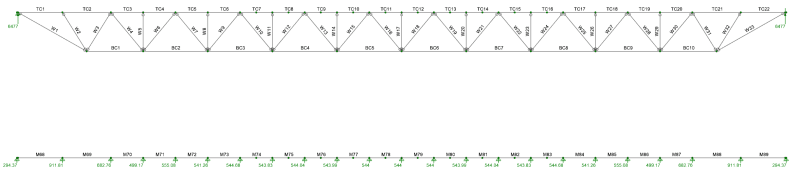

Hi All,
I am modeling a steel joist in RISA and I am curious about what is the correct and/or permissible way to analyze the top chord for bending moments. What I mean by that is that if I model the joist as a whole I am getting different moments for the top chord than if I would model the top chord as an independent fully supported continuous member. The difference is substantial as you can see from this screen shot.
The top diagram is just the top chord as a continuously supported member. The bottom diagram is the chord as part of the entire joist. Which way are you guys using to determine the required bending in your top chords?
Thank you!
Modeling the joist in its entirety will give you more accurate results.

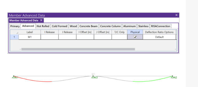

Not exactly true. At least it wasn't a few years ago. There are two considerations here.
Issue #1: The forces and moments reported in the top chord
When I worked for RISA, there was a Global Model Settings - Solution input called "Number of Internal Sections". This was (by default) set to 100. Which means the program is looking at approximately 100 locations for calculation of moment and forces.
That's almost certainly why you're getting different results for the single member vs broken member moment diagrams. The single member model doesn't capture the moment as accurately at the internal joint locations.
Issue #2: How to handle bracing and member code checks
My guess is this might be what DaveAtkins was talking about. It can be easier to specify how a member is braced or unbraced when you use one long physical member. Though I think this is still a matter of preference and user input, as both method can give good results for code checks when handled properly.
Does the discrepancy involve the dead load from the remainder of the joist members? If you run just a LL combo, does the discrepancy still exist? I would venture to guess the "whole joist" model is more accurate. But hard to tell with the info here.
what support conditions did you use in the top chord only beam model?
It's essentially the difference between spring supports (equivalent springs based on bottom chord + web assembly stiffness) versus rigid supports. I think celt83 is alluding to this...
I'm squinting at the image and it looks like the first model has rigid vertical supports at each panel point. I don't think this is a realistic representation of the top chord stress state.

You are correct. I had the number of internal sections set to 100. I maxed it out to 200 and the end panel moments have gotten closer, but the mid-span moments are still about three times larger on the full joist model than the independent chord model.

I used originally had a pinned support at the left and rollers the rest of the way. I have since changed it to all pinned and it did not change any results.
One of the reasons I am asking this question is that according to the original manufacturers design data the bending moments appear to be based on a chord modeled independently. In fact they match the independent chord model almost exactly. SJI has a sentence saying that the top chord shall be designed as a continuous member subject to combined axial and bending stresses. Not sure if they are saying that it can be modeled independently or if they are saying that to just be sure to consider the continuity that exists.
I don't believe the intent of SJI saying to design it as a continuous member is meant to be interpreted as modeled independently. I believe the intent of this sentence is for the modeler not to apply member releases to the top chord at the segments between panel points and also to manually set the appropriate unbraced length.
Regardless you could model it independently but the independent and the full model need to be compatible and result in the same stress states. The get a compatible isolated top chord model you'd need to both apply various axial loads to get the correct axial stress state and either determine appropriate spring supports or equivalent intermediate vertical loads. The effort involved to do the above is likely much more than just modeling the joist.
For your joist model it's not clear if you have this modeled as pin-pin but if so recommend pin-roller instead.

why do you think you need more accuracy out of the full joist model? 100 section slices to generate the diagrams already looks like it is giving you a really smooth plot.

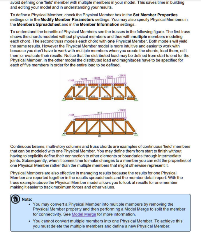

Make sure you have the top chord defined as a 'physical member' in the members spreadsheet. [URL unfurl="true"]https://blog.risa.com/post/what-are-physical-members[/url]
Otherwise, you can split the top chord member at the joints so you end up with multiple members, but do not release moments at the ends of the members. Doing this makes managing results a little more cumbersome but will give you more reporting stations.

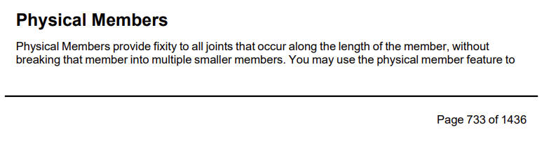

The user manual discusses this. Search "physical members" in the manual. [URL unfurl="true"]https://risa.com/assets/documentation/General_Reference_3D.pdf[/url]

I believe your suggestion (modeling the top chord as a single physical member) is the SOURCE of the problem I was describing to the OP, not the SOLUTION.
That being said, I have looked at his image on a higher resolution model and I'm not certain that my suggestion was the real problem he was looking at. If the OP had modeled the top chord the same way in both images, then my suggestion of internal vs report sections was probably NOT the cause of the difference.
Rather Dave Atkins had it right from the beginning.... that modeling the entire joist would give more realistic moments in the top chord. Because the top chord forces are affected by the overall truss behavior. In particular the vertical web members don't provide as much support as the diagonal members... which we can clearly see from that moment diagram (now that I look closer).
waytsh - I think the first chord-only model is representative of the stress in the top chord if you had shoring props placed at each panel point. I say just delete that model and use the full truss model and you're good to go.

I actually did have the top chord split into individual members at each panel point and they were defined as physical members in each model.
One of the things that seems suspicious to me about the entire joist model is how the negative moment is not fully developed over the verticals like it would be with the fully supported chord. This does not seem to be related to the stiffness of the vertical member itself because when I switch out all these vertical and web members to rigid sections it still occurs.
bones, for what it is worth, the design data I have from the manufacturer seems to show that they ignore the eccentricity at the end of the joists and just bring the end web up to the support. Now they do cut back the span a bit, about 3" on either side.
You are still trying to compare two incompatible models.
Abandon modeling the top chord on it’s own and just use the full joist model.
