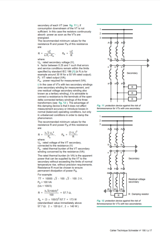

This comes from a Schneider Cahier Technique.
The exemple in figure 11 is exactly how its done in the panel I am working on. The cahier technique even has explanations on how this setup prevents or damps the phenomenon of ferroresonance. However, I understand the setup at figure 12 is said better than the one at figure 11.
I guess I will keep the resistors. They will not be any kind of problem for the new SEL-751 and at worst they will stay there for nothing. At best, they will keep preventing any kind of ferroresonance by keeping a constant load on the VTs.

For everyone's interest (who are interested on the subject). SEL wrote to me to keep any ferroresonance protection if there was any as the relay does not prevent it in any way.
I’ve installed resistors that way exactly once.
Using aux PTs and a broken delta connection seems much preferable as it doesn’t load the PT under normal operation and possibly reduce the measurement accuracy - the PTs would only be loaded under ground fault conditions.
Edit - as an aside I plan to do exactly that next week for a small gen - we have some spare aux PTs that we’ll wire up to a single 120 ohms resistor. Right now it has YY PTs and I’m going to add a set of aux PTs in broken delta.
I have encountered two different installations with Yg-Yg PTs and no damping resistance connected to the secondary that went into ferroresonance while they were running ungrounded on the high side (normally they were connected to high impedance grounded systems) and a transient occurred to start it. In both cases protections tripped on volts-per-hertz (24) elements; looking at high sampling frequency secondary waveforms it was probably for the best though as the voltage was significantly elevated (>2x nominal peak voltages).
The resistors are there to protect the PTs and have no bearing on the relay, provided your PTs have sufficient burden capability to drive them without causing a significant steady state voltage drop. Agree with wcaseyharman that aux PT's with resistance in the broken corner delta secondary is the preferred way to go though versus introducing steady state loading and heat generation.
