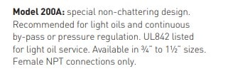

I have the following concerns. There are four units in the plant. All units have a pair of the same rotary pumps. I have checked pump motor and based on pump datasheets we should have 19 USGPM @ 50 psig flow.
One unit have 1/2" Crane RVs. Three other units have 1" Kunkle 200A-E01-M6 with set pressure @ 50 psig. Based on PRV nameplate and Kunkle datasheets 1" 200A PRV can only relief 3 USGPM @ 50 psig with 25% lift (62.5 psig at PRV inlet), 18.4 USGPM @ 50 psig with 100% lift (100 psig at PRV inlet).
Three units have 50 psig, one unit has 60 psig gauge reading at pump discharge side.
Is it OK to have set pressure of PRV so close to pump discharge pressure?
Is Kunkle PRV size and set pressure selected correctly?

Looking at the latest Kunkle Data Sheet for a 1" 200A the capacity at 50 PSIG (25% Overpressure) is 25 USGM.
Set pressure for PRV's is typically 10% over the operating pressure (MAWP)- These (non Code) small screwed PRV's have long blowdowns (reseating pressure) which should be taken into consideration. You mentioned earlier a set pressure of 50 PSIG with an operating pressure of 50 PSIG - that doesn't make sense and the PRV would be always open.

curtis,
I don't think you're listening to us.
These valves are NOT acting as pressure RELIEF valves, but Pressure REGULATING valves.
The 200A form emerson site clearly states the 200A is for continuous flow.
Rotary pumps are PD pumps and need somewhere for any excess flow/pressure to go otherwise they explode.
So the set pressure of these valves is setting the discharge pressure of your pump. Set it at 30 psi it will be 30 psi, set it a 70 psi it will be 70 psi.
Sorry, but this makes no sense to me "18.4 USGPM @ 50 psig with 100% lift (100 psig at PRV inlet)." You can't have two pressures existing at the same point (inlet to the valve.
It is likely that 100% lift will be at some extra margin over the set point, but I can't believe it is 100%. I think you may have misread this, but please post the data sheet.
Bottom line - they look good to me, but we can't see everything you can so very difficult to judge from a distance.

I'm in the LittleInch camp. The PRVs are controlling the pump discharge pressure. That's why "set pressure of PRV so close to pump discharge pressure".
Good Luck,
Latexman
No.
The 60 one has just been set a bit higher and needs adjustment I think. Read my post above....
"So the set pressure of these valves is setting the discharge pressure of your pump. Set it at 30 psi it will be 30 psi, set it at 70 psi it will be 70 psi."
