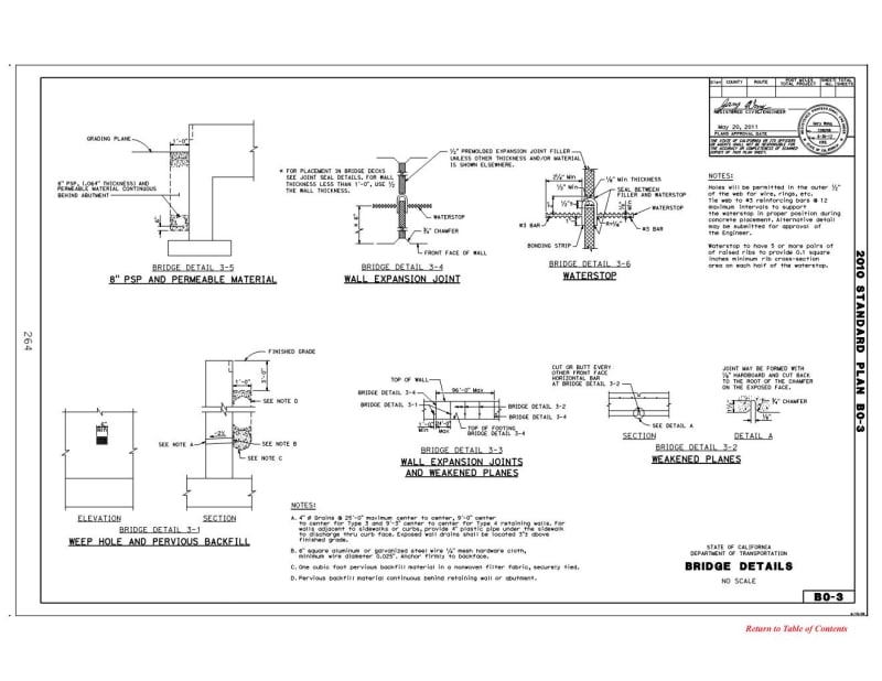

2) Are you aware of places in any relevant code books (IBC, ACI, etc.) that gives insights on drainage design for retaining walls? I feel confident in the drainage I have called out on the detail (drain rock, perforated pipe, etc.) but I'm wondering if there is any sort of standard to reference when designing for drainage?

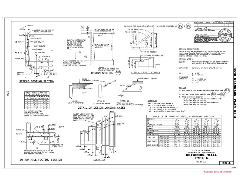

Here's the link for the retaining wall detail: Link
 https://files.engineering.com/getfile.aspx?folder=db3968f4-30c5-45bf-856f-0e0e468212aa&file=Retaining_Wall_Detail.pdf

I’ve never really trusted weep holes to not get clogged even if the neighbor wasn’t an issue.

#1. Seems like the footing will help as long as you can develop the moment in it.
#2. Regarding drainage, I'm not sure where a "code" specification might be but I'd want to make sure there is a place for the water to go. In other words, if you have weeps - Is it ok for the water to weep on to the neighbor? If you have a drain pipe behind the wall, where does it daylight.
You also lose 1 1/4” of your depth in the stem when you offset the dowels from the verts. I don’t think you want this but that’s what the cartoon looks like.
If you put a proper rodent screen in them, I've had them work for decades.

Always add a water table substantially above your drain... count on poorly maintained drainage. Add filter fabric around your perforated pipe. Provide water proof membrane against the back side of wall so water doesnt penetrate and rust your steel.

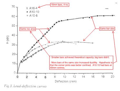

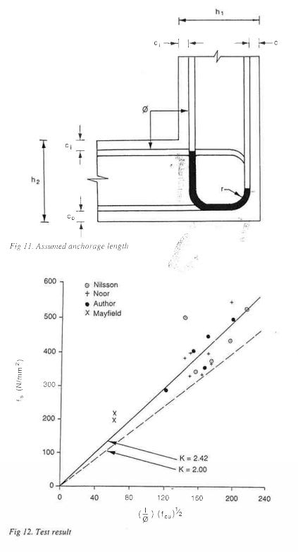

i found some doods masters thesis
he quotes alot of nilsson stuff for people who dont have access to his material
also strut and tie model to analyze retaining walls
Really great stuff here. Thanks for sharing. From everything that's been said here and on other threads it sounds like those 'D' bars are really important in getting full moment capacity out of the joint but most engineers aren't putting them in on smaller scale projects. In that thesis he makes it sound like having top bars in the slab is a good alternative for putting in the diagonal bars.

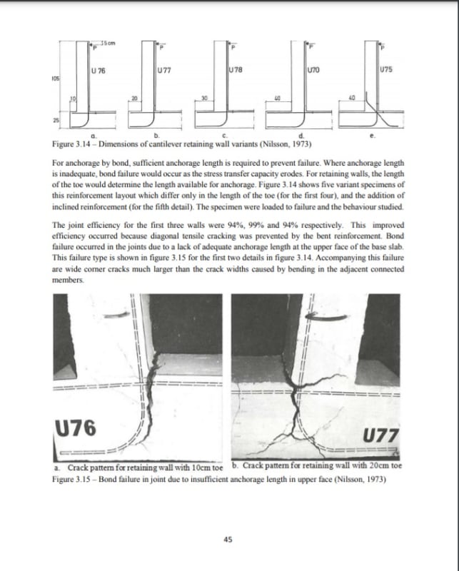

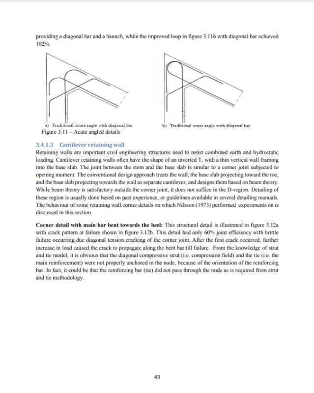

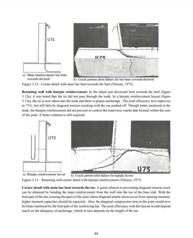

i dont think it is a requirement but you may not be able to get sufficient anchorage on
prescribed development lengths or geometry limitations (like your case)
NOTE: anchorage cannot be achieved by bending into the heel as your tie needs to be anchored into the node
the guy describes this when his FEM results have better performance than Nilssons experimental results
i think the takeaway though was your detailing of bending towards the heel
which D bars will not help the diagonal tension failure here (SEE FIG 3.13 where sufficient anchorage was provided)
see his quote "The use of looped reinforcement arrangement of the main tension reinforcement properly done gave the
best result. Adding a diagonal bar at the re-entrant corner improved the result even further for looped details.
However, the use of diagonal bar does not help significantly for details susceptible to diagonal tension
cracking
. However, where stirrups were used for such details, and placed in a fan-shaped arrangement (i.e.
smearing outwards from the inner corner to the outer, thus crossing the crack trajectory) improvement were
made and the joint thus reached full capacity. This is however contrary to the result Nilsson (1973) obtained
with stirrups, as the stirrups gave marginal benefit in that case, without reaching 100% efficiency. More
experiments from other authors could clarify this discrepancy.

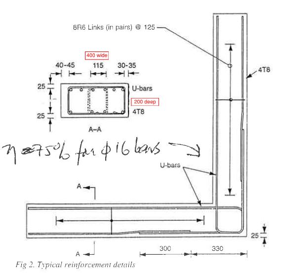

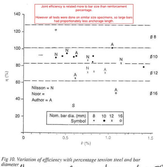

On the impact of increasing joint size for a corner joint susceptible to failure by diagonal tension failure,
three sample of different size with comparable reinforcement ratio (for the tradition layout in figure 3.3a).
The specimen sizes were 150 × 250 𝑚𝑚2 , 150 × 350 𝑚𝑚2 and 150 × 450 𝑚𝑚2. Thus, with each
increase in specimen thickness, the lever arm increased. As expected, the failure load increased with
50 increasing specimen thickness, thus the section could carry more. However, the joint efficiency reduced
with increasing thickness, as the sections still failed by diagonal tension. Diagonal tension failure depends
on the tensile strength of the concrete (where stirrups or crossing reinforcement is not provided), and thus
increasing section thickness only increases the length of the crack path, but not concrete tensile strength.

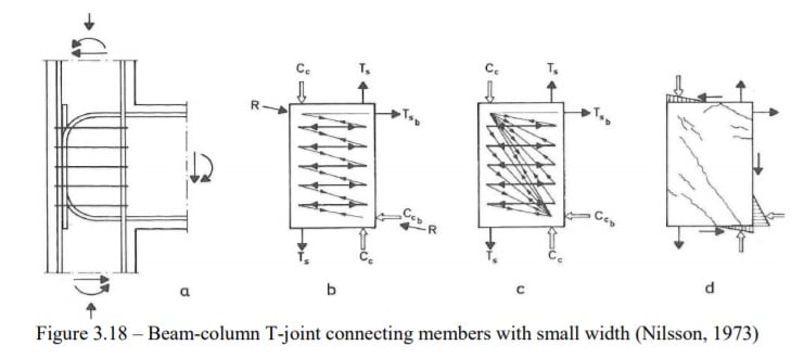

the guys STP model shows how to calculate the transverse tensile force. (im not a STP expert though to confirm the accuracy)
see his quote "Thus, a tension force of 145.4𝑘𝑁 is estimated from the transverse tensile stresses within the joint. Even if cracking is not prevented, the structural detail of the wall-base connection should be capable of preventing diagonal tension cracking failure from these tensile stresses. Typical strategies used for this purpose includes bending the main reinforcement into a loop within the joint, use of inclined stirrups to control the cracks, use of bent bar to cross the strut path etc. This topic was discussed extensively in section 3.4 of this report"
the guy goes on to talk about detailing ties transverse (or inclined stirrups) to this strut to accomodate the diagonal tension
i have not seen any details like this for retaining walls (if anyone would be much obliged)
maybe just traditional vertical ties and stirrups to confine the strut?
but
as suitable quoted since not seen in many cantilever walls

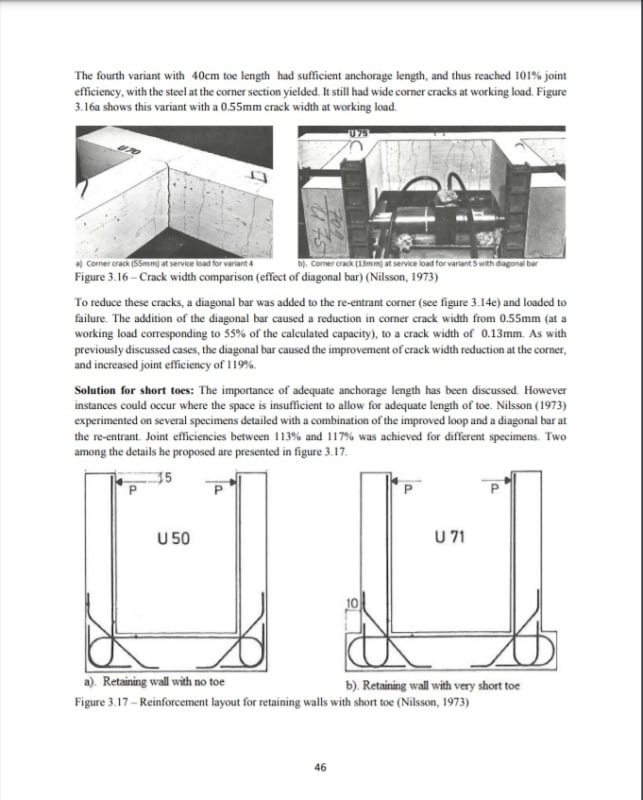

"In concluding this section of the report, it should be noted that Nilsson (1973) regarded the use of stirrups
in corner joints as difficult to construct on site. It could also lead to congestion of the joint which may result
in difficulties during pouring and compacting of concrete. Unlike Nilsson however, several other
researchers recommend the use of stirrups within the corner joint to control diagonal tension crack failure.
it seems like the economical solution is to loop the stem steel or hairpin with additional bars SEE FIG 3.17 in my post above
or turn the bend in the direction of the toe (SEE FIG 3.14) <--- this method could suffer from insufficient anchorage hence D bars
Because Nilsson's tests have been brought up, and the initial design was an 8" stem matching the ~200mm used in lab tests, I'll give a pointer to the following interesting articles on opening corners by N. Jackson (possibly Neil Jackson). Jackson revisited Nilsson's tests and those of another researcher (Noor), supplemented with his own tests. Only overlapping U-bars are considered as that was the ACI recommended detail at the time, but there should be some relevance beyond this. U-bars would be my recommendation for the wall under discussion here.
Jackson's hypothesis is that the ratio of available bond length within the corner to the bar size determines whether full strength and ductility are achieved in the opening corner joint - similar to the usual calculation of bar development. The images below are from the first article (without diagonal reinforcement), with my summary in red. Note that researchers tend to use smaller bars than real structures so Nilsson's raw results would be optimistic for 5/8" bars.
The diagonal bar article gives recommendations on diagonal quantity for a given crack width at service loads. As a bonus, the diagonals increase the section capacity within the joint because they pass through the tensile zone at the critical section, which reduces the stress in the main U-bars, but this is not considered in the ultimate design.
Corners without diagonal bars:
Corners with diagonal bars:
