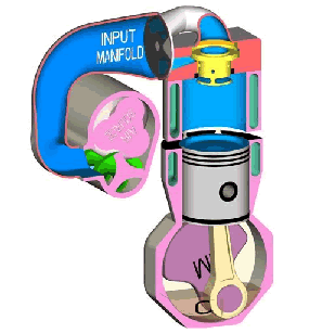

here is my sketch of a conventional crankshaft driven RUDIST (reverse uniflow direct-injection super-turbocharged) engine:
Link
There's more info I got I just wanted to get this up here first and i'll keep adding to it. I would appreciate your thoughts on this engine design. Thank you!

I am talking about just making a RU CI engine with a conventional crankshaft; there's just too many issues to try to combine into both designs. So could we please focus on just the RU and not the cam engine anymore please?
The Commer TS3 has too many moving parts, too much friction, and potential for breakage. Why is RU better than a DD? Valvetrains do lose a considerable amount of energy through friction, they are also expensive, require maintenance, take up space, and heavy. Yes Brian, the valve in a RU does use some energy from the pressure differential to move the valve, but it doesn't lose all that energy through friction like a valvetrain would. With a RU, whether CI or SI, it is possible to run boost, which none of the other 2s engines are able to do (at least not a significant amount of boost) that to me is a major advantage that allows the power density and efficiency to be increased. The bombardier and mercury engines cant run boost, they require the orbital air injection system, which seems like a weak link to me; those engines also have to use their REV exhaust valves, to change the volume of the exhaust port, another potential weak link. Those engines also are still a total loss oiling system, whereas the RU is lubricated like a conventional 4s. So yes, the bombardier and mercury 2s are not suitable for 100,000s of miles like a RU engine could be.
Another advantage of RU vs. uniflow, the pressure wave from combustion, which is traveling downward during the power stroke, can continue going in its natural direction and exit through the exhaust port; whereas in a uniflow that pressure wave has to be forced to turn back around and be pushed out a valve in the top, which exposes the exhaust valve to extremely hot temperatures and reduces it's lifespan.
CI would be the easiest to control with a RU engine, so I would like to focus on just CI. SI is definitely possible but gets more complicated with injecting fuel directly into the cylinder during the compression stroke. To me, the idea of not having to worry about replacing a $3,500 timing chain system after 100k miles is attractive just by itself. My mother had an Audi A4 with the 3.2L V6, the chain tensioner had a problem, which made the chain skip a tooth. Long story short, they had to pull the whole motor out to fix the timing chain system, which cost $5,000. And then the new tensioner failed, so the shop (they specialize in Euro cars) had to pull the motor and do it all over again. Timing belts break all the time, timing chains have all sorts of expensive issues, i'm a mobile mechanic so i've done plenty of timing belt jobs. If i could have a simpler engine that didn't need a valvetrain id be all for it. That's why I like 2s so much, they're high power density and mechanical simplicity. So if I could have a 2s that didn't have all the issues they normally have, like terrible emissions, poor efficiency, burning oil. Thats what the RU engine offers, the best of both worlds from 2s and 4s.

OK, so now you are backtracking, to what amounts to essentially a Detroit Diesel but with the scavenging running in the other direction, and skipping the crazy cam-and-linkage piston mechanism. Good move.
Re the pressure wave ... it's not significant. The speed of the piston moving down (10 - 15 m/s) is insignificant compared to the local speed of sound (400 - 500 m/s at elevated temperature typical of the end of the expansion stroke). When the exhaust ports/valves open, the whole cylinder will "know" within a small number of crank degrees.

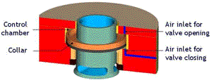

The valve design is critical and the good news is this work has already been done by LIM Technology. They designed and patented the valve, although I believe the patent has expired because of non payment of fees.
Here is a picture of the valve:
It is possible to use these valves with a clock spring, or control them entirely pneumatically. I was also thinking about Samarium Cobalt magnets as the springs since they can handle high temperatures; although the temp could be too high but it's an interesting idea if it could work.
Using a valve design like these would sabe a considerable amount of space and weight. They could be light enough, to move fast enough, to work up to decently high rpms. Since I'm focusing on a CI engine the rpms shouldn't be too high anyways. Also, since it's 2s it doesn't need to Rev high to make good torque.
Another thing is the springs for the intake valves don't need to have very much force. Engine tests from LIM found that all the spring does is help the valve close faster. They were actually able to run one of their prototype engines with no pneumatic or metal springs; it ran terrible but it shows how it's really the air pressure that causes the valve to open and close, the spring just helps it return closed. By simply adjusting the force on the valve, allows the valve to open and close at higher rpms; it is similar to a VVT but obviously much simpler.
The reason why the dual charger setup is used is to provide the positive pressure necessary to operate the valves and scavenging. It is possible to use only a supercharger but I believe by having compression done in 2 stages, from the turbo compressor first and then the SC, and using water injection after the TC compressor and before the SC. The dual charged setup would have the highest power potential; it could also be more efficient.
So what's the point of these valves? There's a lot not to like about this design- no pure mechanical retention (if the spring breaks, where does the valve go?)
What looks to me like inferior curtain area compared to a similarly sized poppet valve
More weight than a similarly sized poppet valve
The use of a clock spring, which is a more fragile arrangement with more flow restriction than a conventional stem/seat/helical spring arrangement

The clock spring just illustrates the concept; you are correct they would perform poorly. Having valves with no mechanical actuation is interesting to me, but a RU engine with a camshaft would probably make the most sense. It would still have all the other advantages still. I wonder if a single cam or double cam would be better.
If there's only one valve, what does the second camshaft do?

I think your assumption that pressure differential can open the valve is dubious, at best.
And even if it can be coaxed to work by some means, the pressure differential is associated with a large source of pumping loss.
Give it up; control the valve using a camshaft like everyone else does. There's a reason why everyone else does it that way and it's not because self-actuation of intake valves wasn't thought of before; it was thought of in the late 1800s and early 1900s and given up on it because it doesn't work well enough.
