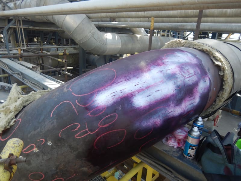

20" Dia CS elbow with multiple cracks on the extrados (Rich Benfield Solution)
Alpha Charlie
Aug 11, 2021
16

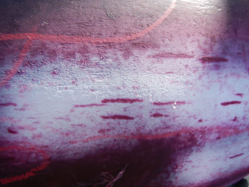

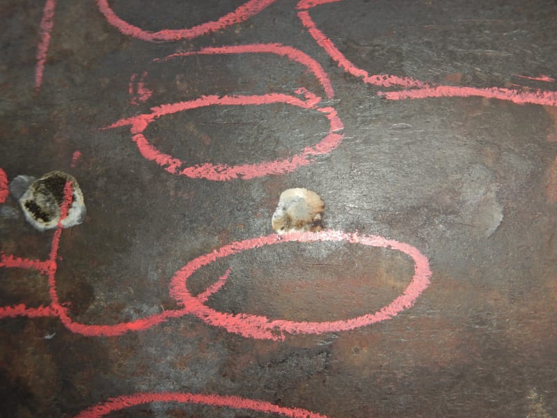

We have a CS 20"-12.7mm THk elbow installed on rich benfield solution. Operating Temp: 123.5 C while pressure: 29.5 Kg/cm2. Line is stress relieved as per process design conditions. Benfield CS lines are monitored against thickness loss. Particular elbow was found with multiple surface cracks on the extrados and few cracks on the intrados. All cracks are in the direction of flow and longest is 4" long but estimated approx. depth is not more than 2-3mm based on hot penetrant test bleed out. CS elbow was insulated with mineral wool.
Any idea what might be the reason of these surface cracks since we never experienced such an anomaly before. Elbow material was confirmed to be CS by PMI of removed shavings.
