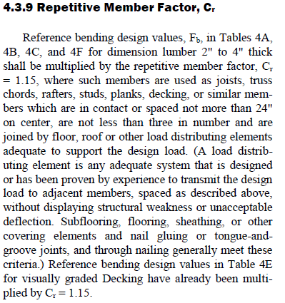

Hi guys, I have a project that has 100 psf snow load. Instead of using typical deck joists with 16" o.c., the architect wants to use large lumber spaced farther apart. I calculated how far a flat 2x can span simply supported with 100 psf snow load. It can span 4 ft and meet L/360 LL deflection criteria with the snow load (I kept duration factor to 1). How about point load from someone standing? What kind of check shall I do? Shall I maybe check 300 lb point load in the middle of the flat 2x6 perhaps? If I do that check, it will be closer to 3 ft o.c. Maybe I should suggest using 3x decking? What are your thoughts?
Eng16080 said:
Considering that the joists will be spaced greater than 2 ft o.c., you won't be able to use a repetitive member factor increase for the joists
Just so it's clear, NDS requires a load distributing element between the members to use the repetitive member increase, and I'm not sure how that would be achieved with drip through decking and no sheathing.
ChorasDen, I might not understand your point above, but in my judgment I would use the repetitive member factor increase for this project if the joists were instead spaced no more than 24" o.c. (and assuming nominal 2" to 4" thick joists). I would consider the connection between the decking and joists as meeting the requirement for "load distributing elements."

Eng, I was interpreting that there is no decking/joist, the OP wanted to only consider flat structural members. It's completely possible I am misinterpreting, however, and need corrected.

I know that was in jest, and I do appreciate it, but just for brevity, I would say the snow would compact, which would violate the NDS note about unacceptable deflection ;).
I was interpreting the design as having flat decking with joists spaced at 3 ft on center with the decking connected to the joists. In my above comments, I was considering the load duration factor, CD, for the joists, not the decking. For the decking, I would use CD = 1.0 (no increase). I think we're in agreement.
