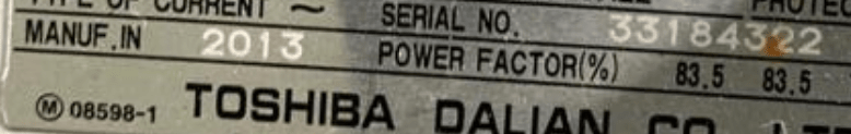

I have a situation. We recently installed two brand new motors(name plate details are attached) to pump units and both failed. They are identical to previous old units which were sent for servicing. One of the new units tripped and the rotor found in jammed state. the second one has one of the phases in open loop(burnt). trying to find root cause of the failure as they were both brand new. the operating current is 5.6amps and rated current is 5 for 415V supply. What is the service factor for 3hp motor or allowed over current percentage? Appreciate expert advise.

Raj2488 said:
@edison thanks. since its a brand new motor and manufacturer strongly arguing it could not be bearing failure
If the motor name plate attached are from the "new" motor it says it is manufactured in 2013.
There is a strong possibility that if the motor has been stored and the rotor not turned during that time.
That the grease has ended up in the lower part of the bearing and that the topp part has rusted, so when you start it the bearing brakes in no time.
Especially if it has been stored in a hot and humid environment.

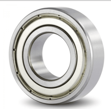

ALTERNATIVE DESIGNATIONS:
These designations mean the same as that the bearing is open.
6206 ZZ
6206-ZZ
6206-2Z
This 6206 2Z SKF ball bearing with the dimensions 30x62x16 is a single-row groove ball bearing with protective plates on both sides.
Advantages of sheet metal sealing are that you get low friction and that the bearing can handle higher speeds.
It protects against shocks and larger particles from eg metal shavings, stones etc.
But less good at excluding dust and retaining grease in the bearing compared to a rubber-tight bearing.
The same goes for 6304ZZ.
Ones we got a motor back from renovation and they hade forgotten to fill the bearings with grease or they forgot to tell us they didn't.
It didn't work for long. :-(

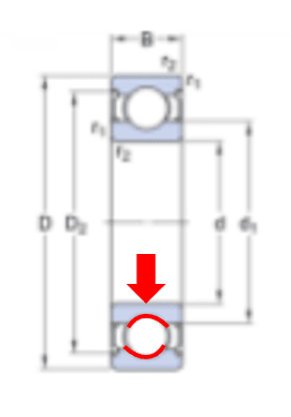

It might be the opposite if you leave the motor in store without turning it all the weight from the rotor will be on the balls at the lower point of the bearing so eventually the grease will be pushed aside and it will only be iron against iron.

Putting to much grease in a bearing can also break it, everything needs place to expand when getting hot.
In this case I would not consider it being a problem since it wasn't a tightly sealed bearing.
