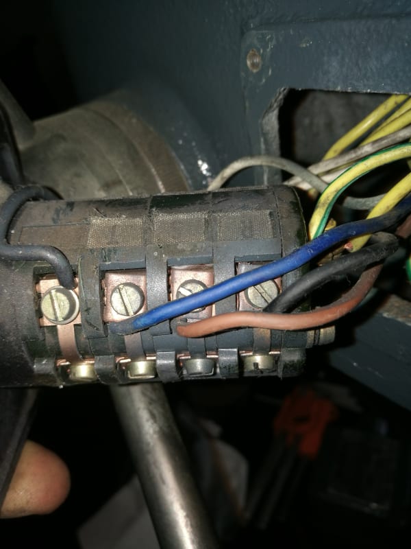

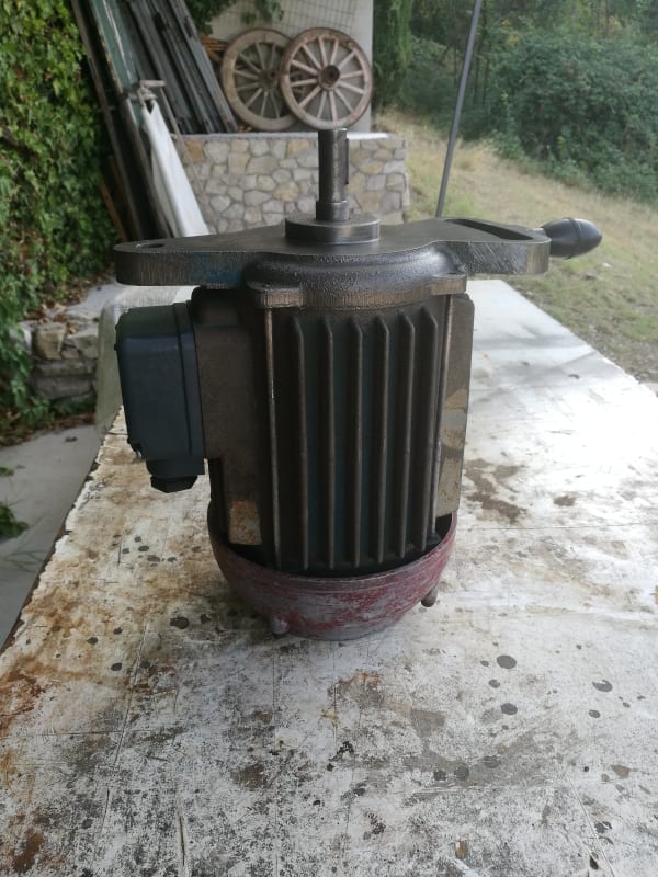

Hi all,
Would anyone be willing to put me right on a few things? I have VERY little electrical knowledge by the way, so I apologise for my terminology...
So, I recently acquired a beautiful old drill press which I have mechanically restored. However the motor is tired.. it was completed rust-welded solid, the drill had lived under a lean-to, nonfunctional for at least 10 years. I've managed to separate it and give it a clean up but I'm sure it needs rewinding. I can see some broken strands, also there is currently a bolt driven into the windings.. also the connection leads are all useless
, the 4 that are still there anyway. The shaft has some pitting, is that a problem?
I'll see if I can get some photos up.
Thanks in advance.
A.
That was my thought also, Keith. There has to be a way to mount that piece onto the end of a "C" face motor.
Ohm's law
Not just a good idea;
It's the LAW!
Providing the shaft of unknown new motor is long enough, I'm sure I could bodge it and the old mounting plate together...but I would prefer to avoid that if possible.
The old one resembled and waiting to find a nice motor man.

Option one:
Step one;
Buy a new "C" face motor with suitable HP and speeds.
Step two;
Duplicate the shape of the existing end piece in 1/2" steel plate.
Step three;
Drill suitably located holes and bolt the plate to the motor "C" face.
Option two:
Buy a new foot mounted motor with suitable HP and speeds.
Step two;
Mount the motor on a flat plate.
Step three;
Step four;
Weld the fabricated plate to the plate that the motor feet have been bolted to.
The choice between option one and option twp may depend on price and availability of a suitable motor.

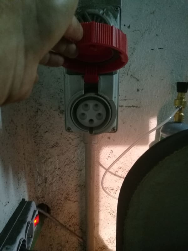

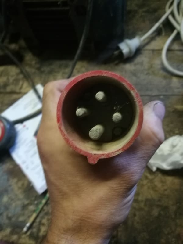

Hey guys,
Please excuse the 3 phase cluelessness, but what's the difference between the 4 pin plug that my motor had and the 5 pin socket in my workshop? Is my motor compatible with that?
That was a lot of photos of the same thing...
Your workshop plug has three phases and a ground and a neutral.
Your motor plug has three phases and a ground.
The motor does not use a neutral connection.
The motor will run off of the workshop supply, but the plug will have to be changed.
Four round pins will not fit into five round holes. At least not this time.
Ohm's law
It's the LAW!
Simple as a plug change... That's the right answer. Cheers waross.
Right answer = the answer I was hoping for.☺️
If you were in the US I would of said you have a trailer plug. But since you are not in the US, like most of us, I don't know.
I hope someone else has the answer.
With your five point socket, measure which 3 points have 3 phase voltage and connect the motor leads to the corresponding pins in your plug. Otherwise, you will end up with single phasing of the motor.

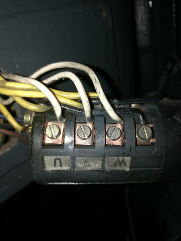

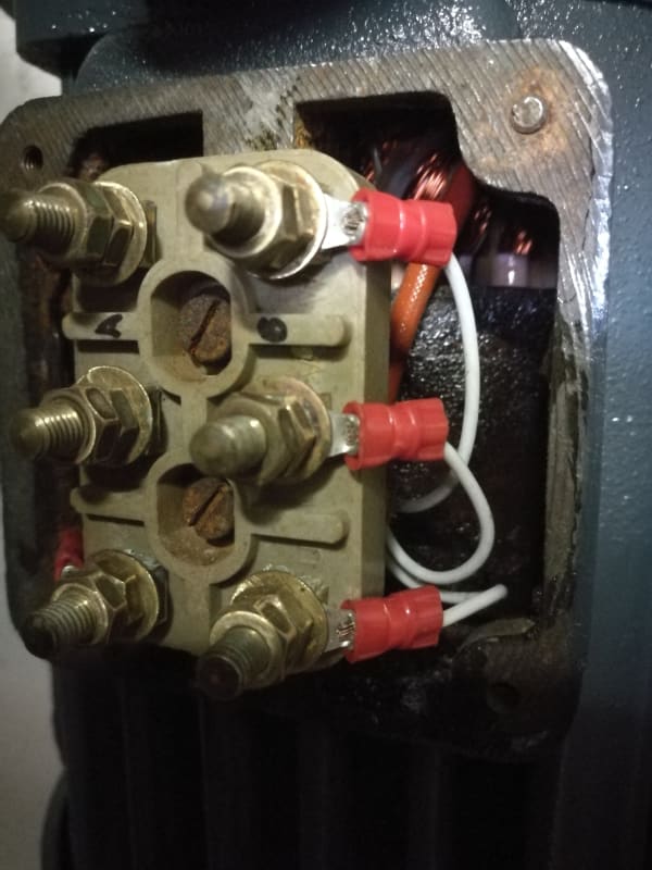

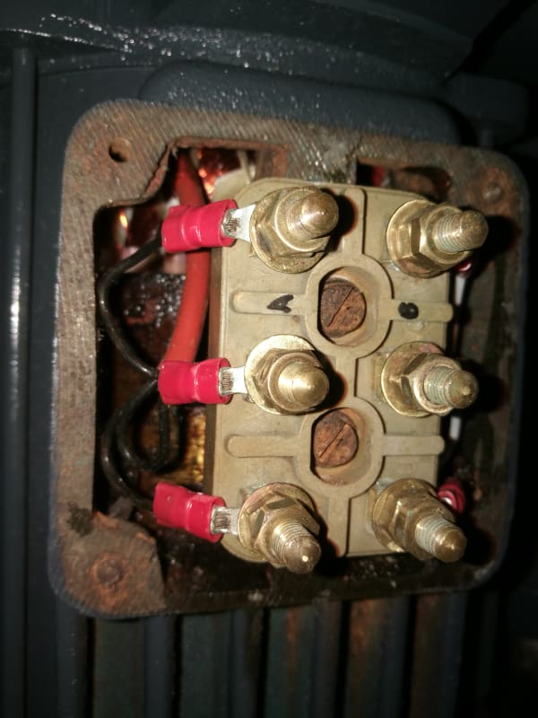

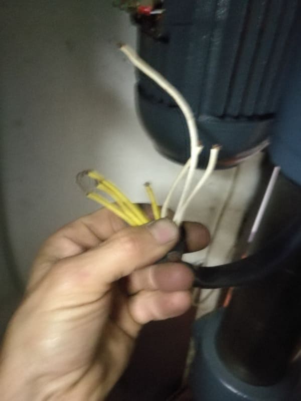

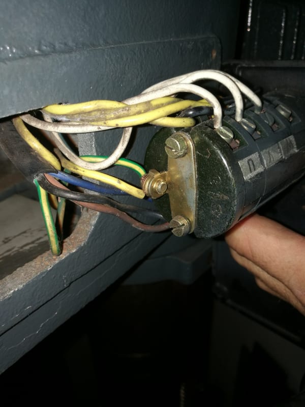

Hello again all.
So, I finally got the motor back!
My next problem is I've no idea how to wire it back up.. can anyone help me out with this?
4 yellow and 3 white coming from the 2 speed switch.. the wiring diagram in the terminal cover is Chinese to me :(
Any help and advice would be much appreciated.
A.
Ask the shop that repaired the motor. They should know and we will be guessing.
