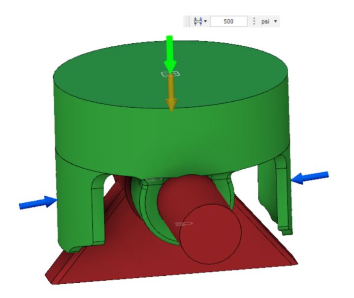

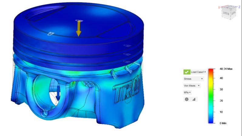

This is a piston I had DMLS printed from AlSi10mg - the geometry is derived from generative design using some basic inputs and a starting shape. It's really just an experiment whether a consumer grade design and print can be bolted in and work for a time.
After machining, it is predicted to weigh ~50 grams vs the OEM 79 grams (1970's Honda XR75). The question is, will this lighter piston result in a small power increase as less work done by reciprocating the piston? Theoretically, the rate at which work is done will be increased?
With the reduced mass, the redline could be increased slightly due to less inertia load, but besides that? Of course, the engine should be more responsive (quicker to spin up) and with a much smaller skirt area, less friction too.
By my calculations, at maximum piston acceleration (~TDC) @ 11,000 RPM, the inertia forces on the piston are about 33% less.

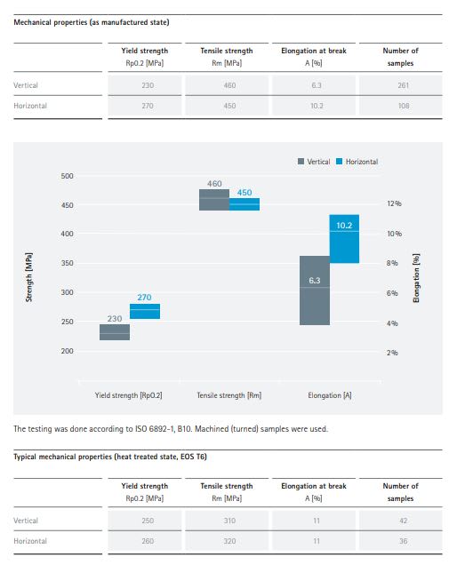

And given the totally unknown fatigue properties (will it match a casting?) the stresses at the pin could become an issue.

With the assumed cylinder pressures and inertial loads, the FEA simulations showed high factors of safety with the additive alloy. But with prints you have possible porosity, poorly melted/adhered layers that may cause fatigue issues.
Generative design starting shape is in green, the red solids are the "obstacles" where material cannot be placed.
Material properties for AlSi10Mg:
