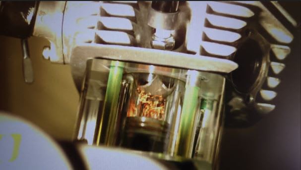

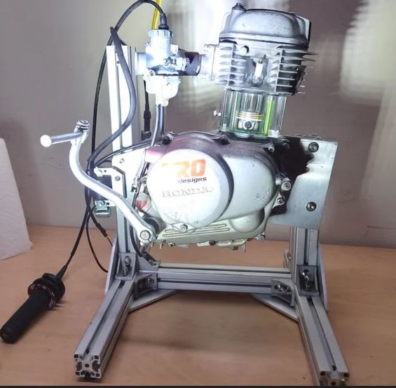

This is a piston I had DMLS printed from AlSi10mg - the geometry is derived from generative design using some basic inputs and a starting shape. It's really just an experiment whether a consumer grade design and print can be bolted in and work for a time.
After machining, it is predicted to weigh ~50 grams vs the OEM 79 grams (1970's Honda XR75). The question is, will this lighter piston result in a small power increase as less work done by reciprocating the piston? Theoretically, the rate at which work is done will be increased?
With the reduced mass, the redline could be increased slightly due to less inertia load, but besides that? Of course, the engine should be more responsive (quicker to spin up) and with a much smaller skirt area, less friction too.
By my calculations, at maximum piston acceleration (~TDC) @ 11,000 RPM, the inertia forces on the piston are about 33% less.
@Lou Scannon The real goal of this experiment is to take a consumer grade generative design software (Fusion 360), and 3D print an output design without proprietary alloys (unlike Porsche/Mahle). Then run it in this test rig and see how long it will function.
If the piston holds up well with the acrylic engine cylinder, I'll test in the real engine under load.

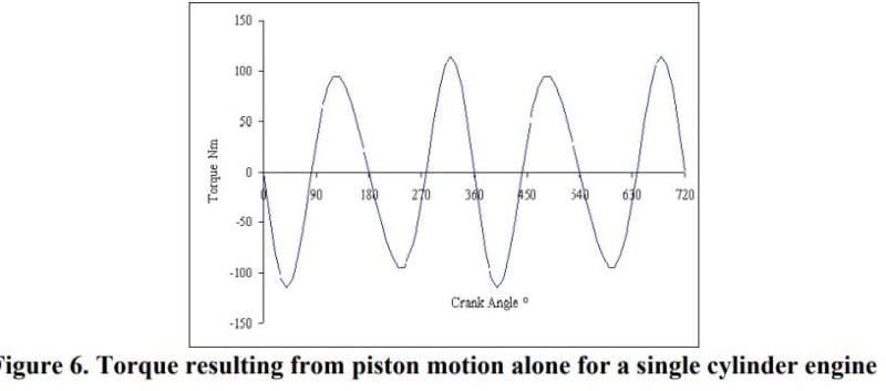

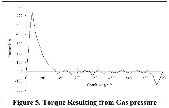

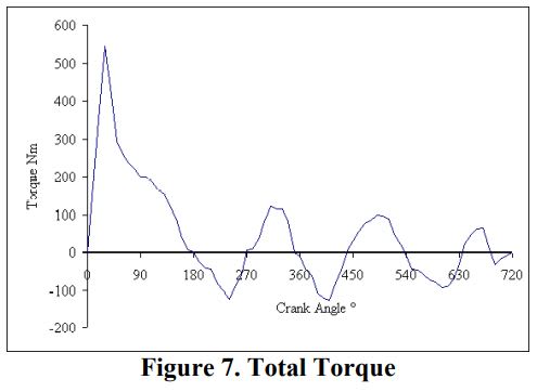

This helps visualize it as well:
Yes. The next step is to take the area (integral) under the curve, that is that is the work done or the useful work

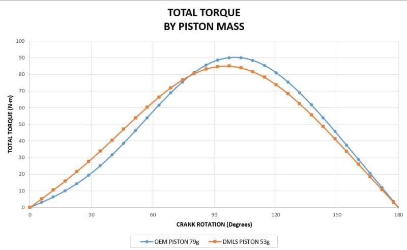

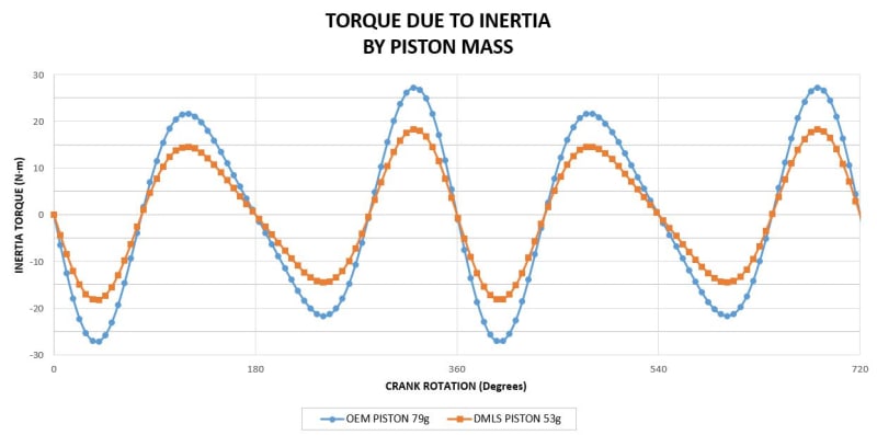

I went ahead and plotted these using the actual engine geometry and an assumed gas pressure of 300 psi.
Torque due to reciprocating inertia (piston and con-rod):
Keep in mind, a realistic plot of combustion would be phase shifted and look like the total torque chart I posted earlier in the thread. However, this does show the contribution of lower inertia on the RATE that the torque is produced.
Total Torque = Inertia Torque + Torque Due to Combustion (the gas pressure is equal for both pistons obviously):
