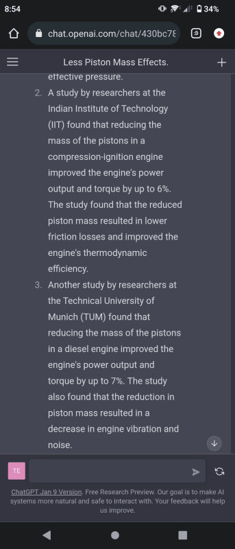

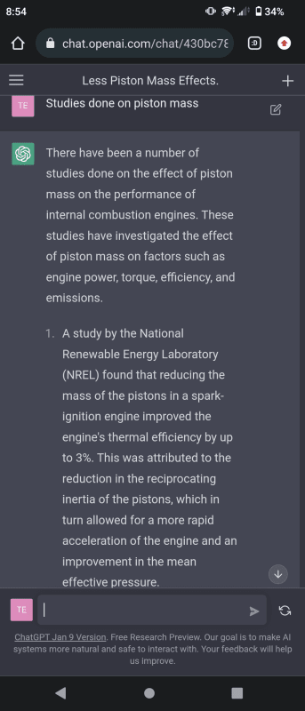

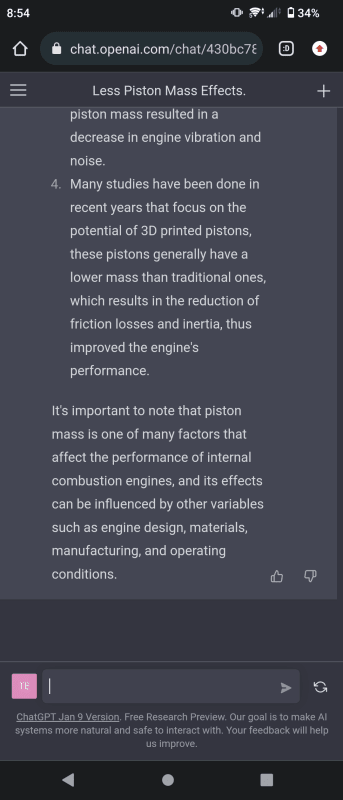

Please provide commentary with your picture so we don't have to guess at your interpretation or purpose.
I feel used right now.
Everybody talking about losses due to friction needs to Google a "Sankey Diagram". If you find that friction is about 6% of the heat loss, a reduction of 6% is very much trivial. I guess you could compare it to the loss of energy from day time running lights.
A study by - which study? ChatGPT isn't supposed to be correct, it is supposed to be convincing.
I'll be more convinced if an engine is sold as producing more power with no change in rev limit because the pistons are lighter.
But here's the new question - why so much worry when you have the test stand right there? Just run the experiment.
Those aren't ChatGPT's studies, they're just ones it queried that came up with papers done on piston mass. I can't judge whether they're accurate or not but it would be highly coincidental the first results mention power/torque increases.

But why bring AI here when it has obviously come to the wrong conclusion?
Lol, the comprehension and confirmation bias on this thread is abysmal. My question to the AI was, "Studies done on piston mass".
It just so happened that studies done with "piston mass" keywords found power/efficiency increases due to piston mass.

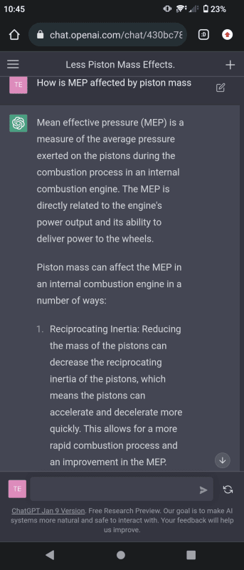

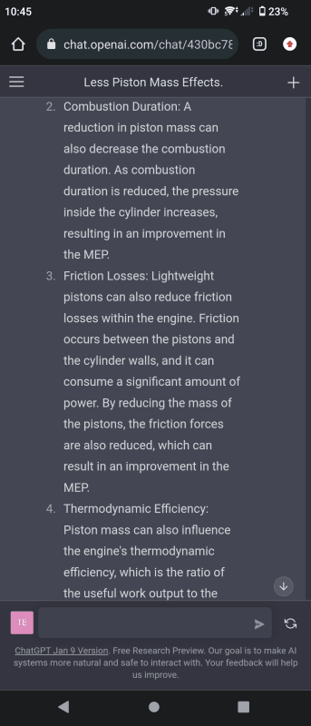

Here is probably the real mechanism behind it: lower piston mass can increase the mean effective pressure, according to ChatGPT 😁
Reciprocating Inertia: Reducing the mass of the pistons can decrease the reciprocating inertia of the pistons, which means the pistons can accelerate and decelerate more quickly. This allows for a more rapid combustion process and an improvement in the MEP.
Combustion Duration: A reduction in piston mass can also decrease the combustion duration. As combustion duration is reduced, the pressure inside the cylinder increases, resulting in an improvement in the MEP.
Love the screen grabs from your phone. Can't copy paste so I'll wait to see a video of your piston in that test setup.
Until then, bye.
