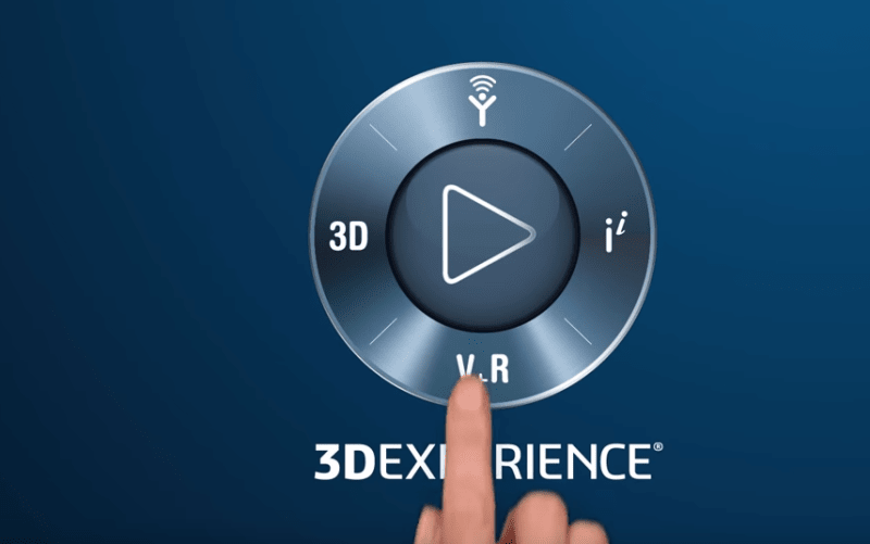

Teamcenter doesn't have a compass for start, like 3DExperience has:
And, also there are no CAD tools enhancements in Teamcenter, like 3DExperience provide for Catia:
It looks so far that I could survive without 3DExperience, but it would be nice to be achieved........[dazed]
