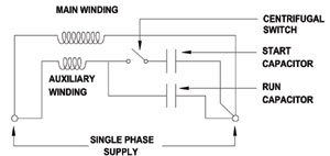

I have no way of having 3 phase, the cables from motor to meter are heavy duty about 6 mm so there should be no volt drop in them at 20 amps or so. The start windings have a 400 µf condenser and the windings have a resistance of about .7? and the running windings have a 60 µf condenser and the windings are about 1.9 ?.

jemjack said:
. . .The start windings have a 400 µf condenser and the windings have a resistance of about .7? and the running windings have a 60 µf condenser and the windings are about 1.9 ?.
Is this really the actual connection on your motor? Something is wrong there, IMO. The starting winding will have a larger resistance value compared to the running winding. That run capacitor (60uf) should be in series with the 1.9-ohm winding and the 0.7-ohm winding ends tapped across the supply. I didn't pay attention to your connections in your OP.
 http://www.acpd.co.uk/sei/s/1488/374.jpg
Hi burnt2x,
Sorry, your jpg. Is exactly what my circuit is, I got very muddled up before. But when I traced your circuit to mine, I found that they were exactly the same, so thank you very much for your help, at least now I know that the motor is correctly wired up.
Best wishes
Jemjack.
