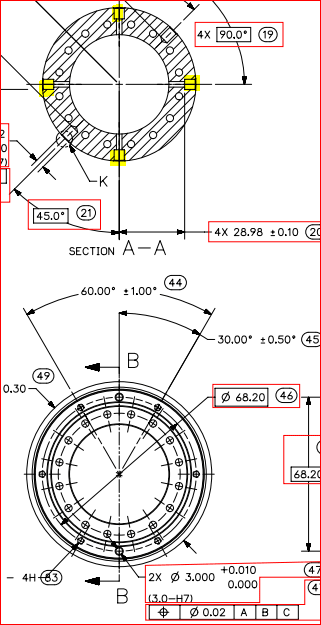

I do not think the Datum selection is not accurate, I was wondering if 4 side holes / counter bores as a group could even be a tertiary Datum ?
See attached print, the 4 highlighted counter bores are Datum C,
R
Yes. The four counterbores can be a tertiary datum.

It's valid - from the tiny sliver of information presented it's not certain to be useful. That's a conversation that either needs an NDA and a check for $10,000 payable in advance or you talking with the people who designed this or both.

Short answer - I would say that the callout doesn't violate any rules, but using a hole pattern as a tertiary datum feaure is dubious from a functional point of view.
If the pattern of 4 counterbores really doesn't constrain the rotational DOF relative to the mating part, then using specifying the pattern as the tertiary datum feature just creates unnecessary uncertainty and complication. It would be more straightforward to just specify one of them as datum feature C, and and use that for the tertiary datum feature in the position tolerance for the other 3. If the 4 counterbores really do orient the part relative to the mating part, then I would say that this design makes the constraint fundamentally susceptible to variation. The rotational DOF would be controlled in a very unpredictable way. On any given part, in general only one of the 4 counterbores would actually contact its mating feature. But we don't know which one - it would depend on the particular combination of location and orientation errors in each of the 4 holes, which would make one of them "stick out" further clockwise or counterclockwise than the others.
I realize that it's a common application, but using a hole pattern as a tertiary datum feature makes it difficult to achieve precise rotational constraint. In order to get that, the holes in the pattern need to be accurate relative to each other, and to the secondary datum feature as well.

No, I meant it in general. By dubious, I mean that we need accurate control over several features in order to accurately constrain the DRF. I agree that a hole pattern might stop the rotational DOF on a wheel, but hopefully we don't use that DRF for a tight position tolerance on some other feature. If we do, then we need to tightly control the holes in the pattern or we will get an unpredictable DRF. Also, for things like car wheels there is additional unpredictability because the parts deform to some degree when the lug nuts are tightened.
There is some tolerance to be gained by designating one of the holes as the tertiary datum feature (with closer clearance on the mating feature) and the other holes in the pattern with larger clearance. In some cases, that extra tolerance could affect the cost of the part. In other cases where it's just as easy to make all the holes accurate to each other, it doesn't lower the cost.

Right, I was going to ask whether the datum feature C reference was MMB or RMB. Either option is problematic in some way. If it's MMB, then there will likely be datum feature shift/displacement. This is difficult to work with using most CMM software. If it's RMB, then I agree that this is questionable. It's highly unlikely that the mating part has four simultaneously-expanding pins.

Datum feature C is referenced RMB, like all our drawings there is never any Datum feature referenced MMB.
The component itself is located to the mating part using the Ø3 dowel holes on the top face.
These 4 counter bores are crucial in aligning another part to this however. So they are very important features although not necessary what should be my Datum feature.
My CMM software will really struggle to check these as a group.
All I can do is create line between the cylinders and create intersecting points etc.
Although if this was not a Datum feature I could check the cylinders individually to the DRF, this would give me maybe more accurate and repeatable results.
