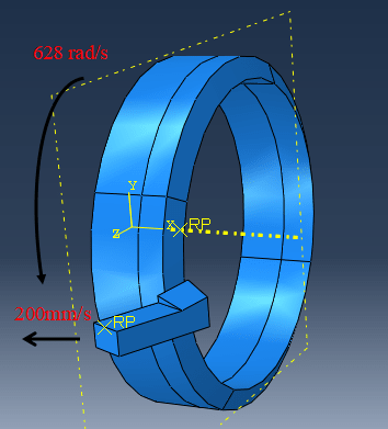

Dear FEA way, I am doing an explicit simulation of external turning. I have tried many times that the final kinetic energy and internal energy never meet the 5% criterion whenever I do the mass scaling setting. Then I tried without mass scaling (and without setting the loading rate), and the final results also did not meet this 5% limit. The results obtained without mass scaling can ignore the 5% limit, right? Secondly, I don't understand what the loading rate is. If I set the boundary condition as displacement, I know that the velocity is the loading rate. If it is a stamping process, I also know that the drop rate of the punch is the loading rate, but if I set the boundary condition as velocity, what is the loading rate? How do I change this loading rate? Thanks!

Hi FEA way, thanks for your answer, the boundary condition I set for my circular tube workpiece is the angular velocity, which is 628 radius/s(100 cycles/s), and the velocity of my tool is 200 mm/s. The step time is 0.02s; I feel the angular velocity in simulation isn't high-speed compared to the actual external turning process. Besides, my tool is a shell at first because I don't want to set the rigid body constraint. I don't know whether it affects the energy comparison or not.

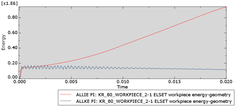

Can you attach the ALLKE vs ALLIE plot that you obtained ?
To remove the contribution of the rigid body you can restrict the energy output to deformable parts.
Dear FEA way, the following picture shows ALLKE vs ALLIE, and I have restricted energy output to the workpiece, but it obviously doesn't meet the 5% requirement. The mass scaling factor is 100, and it takes me about 5 hours[sadeyes].
What about the other outputs - do the remaining energies look correct ? How about the contour plots and animated deformed shape of the model - do they agree with the expected results ?
With these conditions of the analysis, the significant contribution of kinetic energy might be unavoidable. Be careful when using mass scaling for this type of problem.

Try replacing the kinematic coupling constraint applied to the back of the workpiece with a rigid body constraint. Also, the kinematic coupling applied to the tool is redundant since you already use rigid body constraint there.

Besides, I don't understand the meaning of "replacing the kinematic coupling constraint applied to the back of the workpiece with a rigid body constraint." Do you mean that I should constrain the left cross-section of the workpiece to another rigid body and give an angular velocity to it? By the way, it would be better if you could share the debugged .inp file you have just done.
What I means is that you should remove all the kinematic coupling constraints. Instead, define a second rigid body (one is already used for the tool) and utilize it to constrain the back face of the workpiece. The rest can stay the same - you can apply BCs to ref node of a rigid body constraint in the same way you did it with ref node of a kinematic coupling constraint. I haven't done this yet with your model, it was just a suggestion.

I just checked your .inp file, here are my 2 cents regarding minimizing the KE output:
1) Increase your step time, as a previous user said, to control KE you will need to apply the velocity/displacement BC over a longer period of time; might require some trial and error. Another solution would be to use slower velocities.
2) Use the smooth amplitude function instead of the tabular one to apply your velocities. This will limit the sudden jerks or "noise" in your energy output.
3) Again, as the other users pointed out, you need to look at the whole energy output and monitor each energy output individually to guarantee the quality and accuracy of your solution. If you want to maintain quasi-static conditions in your simulation, then yes keeping KE in check is essential. If you're running an impact analysis, a sudden increase in KE is expected.
4) I think your mesh is too fine. In explicit analysis the stable time increment is controlled by the material properties and size of the element. Since you want to limit the mass scaling factor to control KE, try making the mesh a bit coarser to get more efficient run times.
5) Most of the points I have pointed out are mentioned in detailed in the manual. Go through the explicit dynamics section, and more importantly go through the example problems in the getting started with abaqus manual. The "circuit drop" and "channel forming" examples have some good information regarding explicit analysis.
