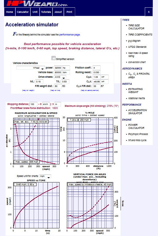

"With friction coefficient = 1.0 "It gave a 9.9sec 1/4 mile time at 179mph."..."
That was a tire traction coefficient = 1.0. The reason drag cars were able to achieve acceleration rates far beyond 1g was primarily due to help from aerodynamic downforce. A modern top fuel car probably produces over 15,000lbf of aero downforce at top speed, or around 6.5x the car's race weight.
If it matters, I re-ran the 80,000lb 32,000hp drag truck performance in HP Wizard using tire and aero lift/drag characteristics typical of a top fuel dragster and got the result shown below. You'll note that HP Wizard lists a default traction coefficient value of 4.0 for a drag race slick. But in reality I doubt this tire would be suitable for use with the 80,000lb truck described, as the typical top fuel dragster only weighs 2250lbs.
Right. That why I said above you should consider 8x racing "slicks" on the back of a truck - with all 8 being driven by 4x DC motors on the four axles. Let the front wheels go up - the back tires stay on their own platform with all wheel getting traction. DC motor will give instantaneous acceleration greater than that of a combustion engine, and the power comes not from a battery but a capacitor bank for quick (6 second) discharge.
