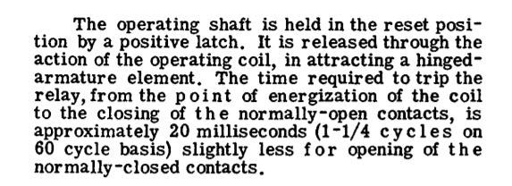

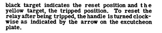

But from my understanding the coil is to realize the latch when tripping and the reset is mechanical?
So the coil should not be energized at all at a reset. [ponder]

Meaning that if the function of the coil is to realize the latch it will be energized as MKFPG sad with 125x125/24 = 651 watts for 0.2 sek 200ms but if you pull it for 5 sekunds it's not made to withstand that, so smoke there will be...

I didn’t read every comment, but was the fault cleared when the guy held the handle to reset for so long?
I really don’t understand why he was holding it so long anyway. If it doesn’t reset either the coil is drawing the latching mechanism or the latching mechanism is broke.
Change the coil, test the 86T, and see what caused it to trip. Forget about trying to figure out how many amps it pulls.

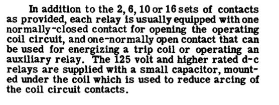

>> "I got 3 wildly different current measurements"
Redsnake's excerpt from the manual mentions a capacitor. Decreasing current could be a function of the capacitor charging.
I was thinking that too, but since no more information or electrical drawings was provided (I am not familiar with this kind of equipment) I didn't point it out.
