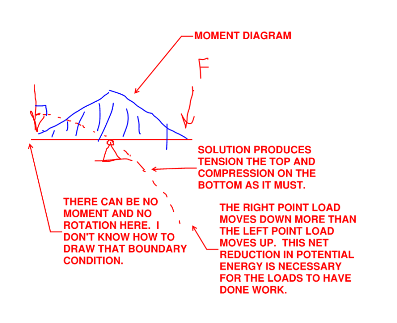

I believe that point [A] moves upwards and does so regardless of the relative stiffness of the three members.
1) Taking moments about the central support reveals that there can be no horizontal reaction at the lower left support.
2) If there is no horizontal reaction and no moment at the lower left support, then the left member is completely straight and has no curvature along its length. I can prove this part separately if necessary.
3) If the left member has no curvature along its length then there is no rotation at point [A].
4) If the left member has no curvature along its length then there is also no moment at point [A].
Taking the above into account and simplifying the structure a bit, you wind up with a beam with a bizarre set of concurrent, pseudo boundary conditions at [A}
a) [A] does not rotate.
b) [A] experiences no bending moment.
I believe that the only admissible solution given these constraints is for the deformation pattern shown below to develop.
