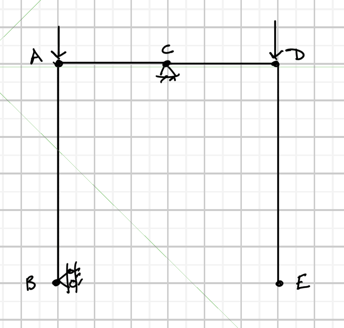

Hi, everyone!

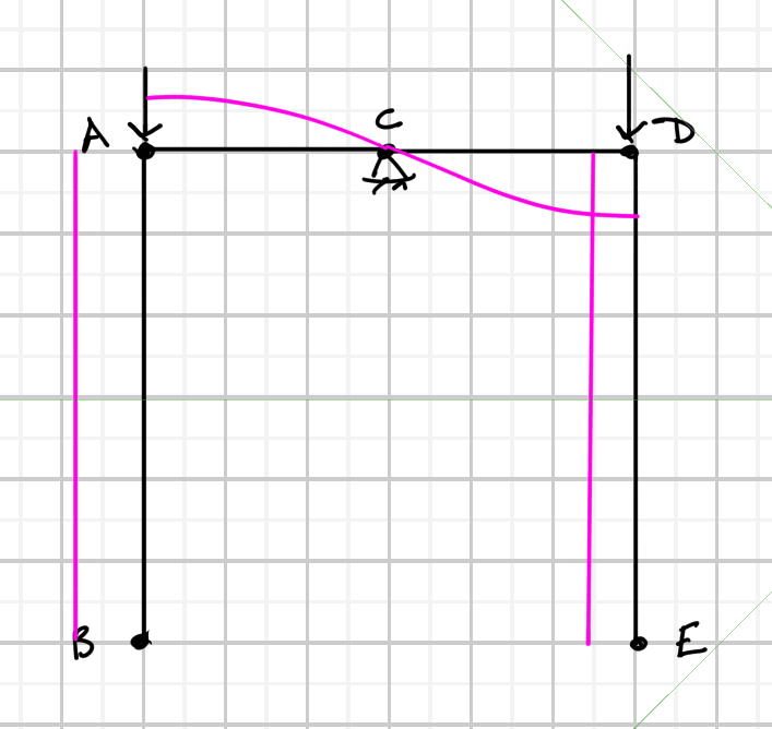

Here is an interesting and funny statics problem, to exercise engineering brains and cheer up.
Given the following structure can you tell, without calculating, in which direction point A will move after deformation:
A) up
B) down
C) will not move
... and why? Point A is not a hinge. No structural analysis programs allowed. 😜

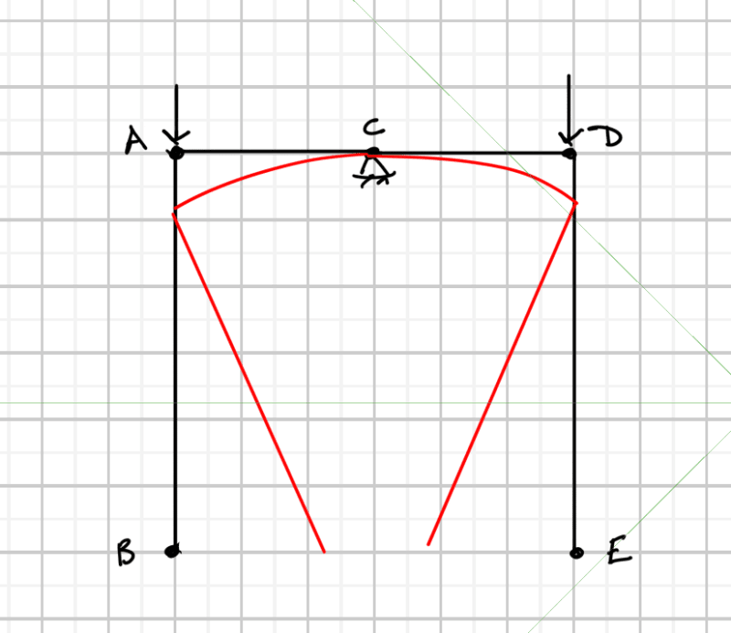

I think Kootk’s analysis is mostly correct. I went through the same statics exercise and got zero horizontal reaction at the bottom left support. It seems like there should be a force though.
I think it would be possible for point A to move down if the left vertical had zero stiffness and weighed more than the right vertical. The problem says nothing about the segments all being uniform, so I’ll assume this is legal.
If the segments all need to be uniform, then I would say that the left end of the horizontal segment (point A) would have to be higher than the right end because the left end has some resistance to deflecting downward but the right does not. But if the right end is lower than the left, that doesn’t necessarily mean that point A goes up.
I would say there is a horizontal reaction at the roller below A.

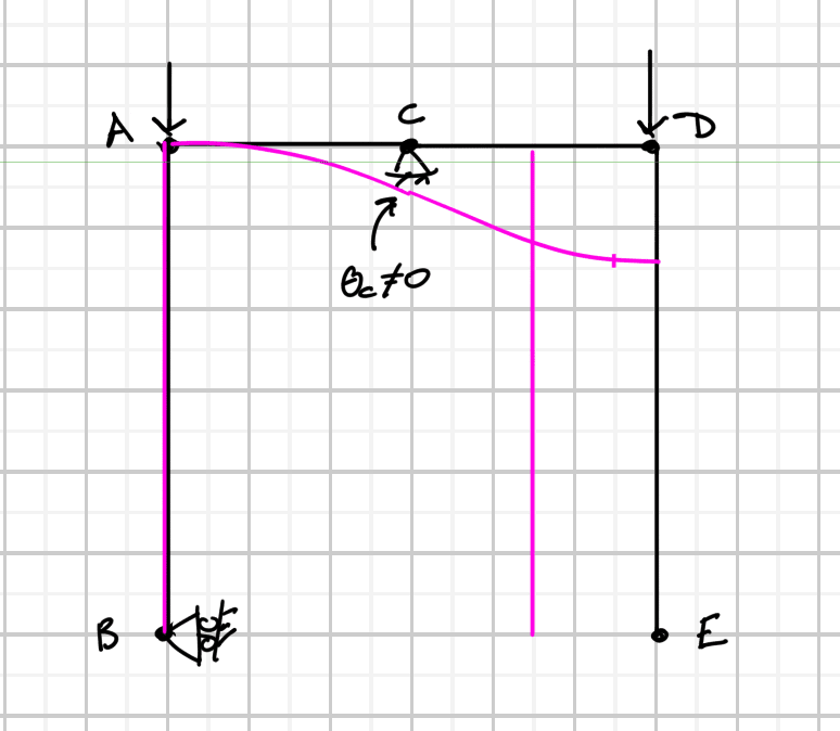

Let's assign points A, B, C, D going clockwise around the figure, so we have A as noted, center support is B, point with applied force on the right is C, and the roller at the bottom is D. X is the horizontal axis, Y is the vertical axis.
Eq 1: ΣMA=RDx*a+F*a/2-RBy*a/2=0 => RBy=F+2RDx
Eq 2: ΣFx=RDx+RBx=0 => RDx=-RBx
Eq 3: ΣFy=F+F-RBy=0 => 2F=RBy
Substitute the result of Eq 3 into result from Eq 1:
2F=F+2RDx => RDx=F/2 (Horizontal Reaction at roller is F/2
like Koot I believe this to be independent of member stiffness, he articulated it much better than I likely am about to:
Lets assume the restraint at B is removed, then the deformed shape and rotation would be:
Deformation:
Rotation:
Note that because there is no loading on the vertical legs and the joints are rigid that their cross-section rotations must be constant and match that of the horizontal member ends,
ΘAB = ΘAC
ΘDE = ΘDC
These are compatibility requirements as KootK noted for the rotations to be different work must be done in member AB or member DE, because there is no load on these members there is no work so this is independent of the section properties.
Now restoring the restraint, then because there is no loading on member AB it's cross-section rotation must become 0 and by compatibility so must the rotation at A:
This has shifted the AC-CD rotation diagram downward by ΘAC of the unrestrained case, which makes the rotation at C go from 0 to -ΘAC. Sign convention on Θ is counterclockwise positive so a negative rotation is clockwise indicating that the slope of the deflection curve coming from A to C is negative which indicates that A is above C since C is restrained.
A does not move to the right because there is no shear in member AB therefore there is no axial force in member AC so no axial deformation can occur and because of the restraint at C the "pulling" action of CD-DE is absorbed by members at the support as bending.
I didn't realize the bottom left is released for vertical movement. That changes it somewhat, but I still think the bending of the top horizontal will produce a moment at point A and a horizontal reaction at the lower left support (balanced by a horizontal reaction at the top center support).
The top bends down on both sides, producing rotation at Point A, which bends the left side vertical in.
I still maintain that Point A will move to the right from the curve in the top member and shortening due to axial compression in the top.
However, because the left side of the top member is restrained against rotation, and the right side is not, the left will move down more than the left. If there's no limit on how far the left side can slide up, I think the unbalanced moment due to the horizontal reaction at the bottom support, will cause the top member to continue to rotate. So, without additional boundary restraints, the system is unstable. I think this is what FEA way's model shows.
Celt - I agree with nearly everything except the lack of axial force in A-C (and follow on tweaks to the presence of moments and shears). If there is no horizontal reaction at your point B, then there would be no difference between the deflected shape in your first diagram vs. the final deflected shape. If there is a horizontal reaction at your point B, then there must be an equal and opposite horizontal reaction at point C, which means there must be axial force in A-C.

"Eq 1: ΣMA=RDx*a+F*a/2-RBy*a/2=0 => RBy=F+2RDx"
should read
Eq 1: ΣMA=RDx*a+F*a-RBy*a/2=0 => RDx = 0, noting that RBy = 2*F
total length from F at the right joint to joint A is 2*(a/2) = a
Under this specific configuration there is no horizontal reaction.
hmmm...I suppose you are correct...
But that leaves the question: why are the deflected shapes different if there is no reaction? If there is no reaction, we should be able to remove the boundary condition and not have it effect the final result. I realize it would leave it 'technically' unstable, but with balanced forces there would be no theoretical rotation anyway.
If the restraint causes the deflected shape to change, there must be a reaction there.

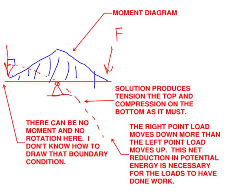

I agree, and that's part of what makes this so interesting. I would answer your question this way:
1) Our conventional analysis techniques seek out only the configuration that is in energetic harmony at the end of the structure's load/deformation journey. They gloss over time history.
2) To get to the deflected shape that the structure finally assumes, there must have been points in time during the load history where, indeed, there was a horizontal reaction.
3) The horizontal reaction strained the left post and the left post relieved itself of that by rotating the entire frame clockwise.
I know, it kind of has one craving the blue pill.

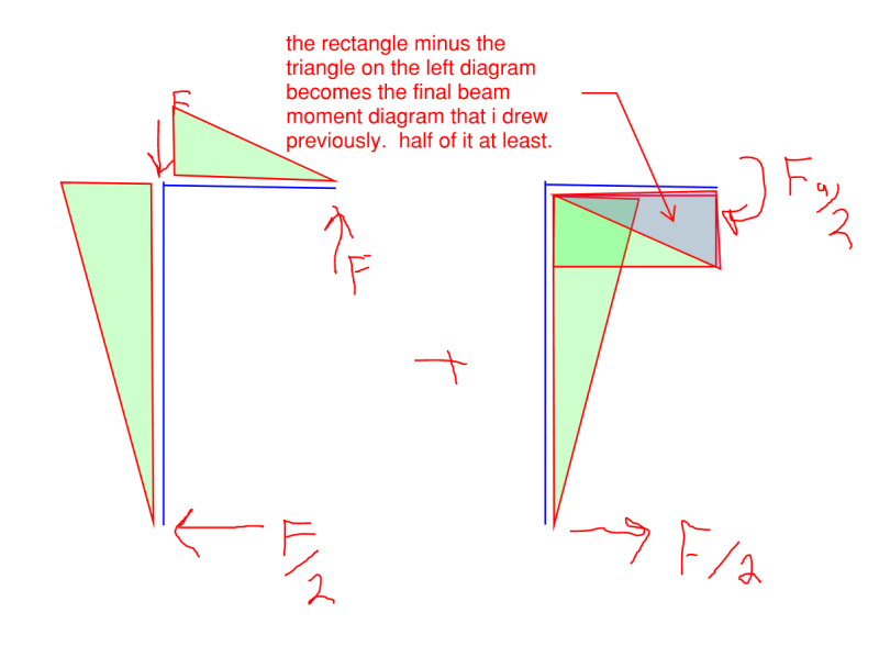

Try it this way pham:
1) Study just the left half of the frame. The rest is extraneous.
2) Use superposition not just as a tool but as a literal expression of loads being added over a finite time span. First the load on the left, then the load on the right.
As you can see, when the two moment diagrams are added together, you get:
a) No horizontal reaction.
b) No Moment at A.
c) No moment anywhere in the left post, and therefore no curvature.
d) The final, triangular moment in the beam that I proposed earlier. Or, at the least, a mirror of it. For some reason I switched from tension side to compression side moment diagrams.
I've repeated the previous sketch below as I imagine that it will be easier for folks to view them together for comparison.

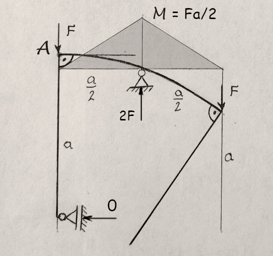

This problem is interesting and funny because the solution is the opposite to what our intuition says. And here is the solution:
First, find the support reactions:
For the vertical support in the middle - from ∑V = 0 => V_t = 2F
For the horizontal support at bottom left support - from ∑M = 0 (around the top support) =>
∑M = H_b*a + F*a/2 - F*a/2 = 0 => H_b = 0
For the horizontal support at top middle support - ∑H = 0 => H_t = H_b = 0.
The bending moment diagram in the beam is triangular with a peak above the support M = F*a/2.
The bending moment in the columns is M = 0.
From now on, the solution may come directly from the properties of the deflection curve (see the picture bellow):
1. Since there are no bending moments in the left column, it remains straight.
2. It also remains vertical because the bottom sliding support does not allow it to rotate freely as the right one.
3. The right angle at the corner should remain right after the deformation.
4. The bending moment in the beam is on top, so the curve is bulged upwards. Since the leftmost tangent is horizontal (to preserve the right angle), point A has nowhere to go, but above the middle support. 🙂

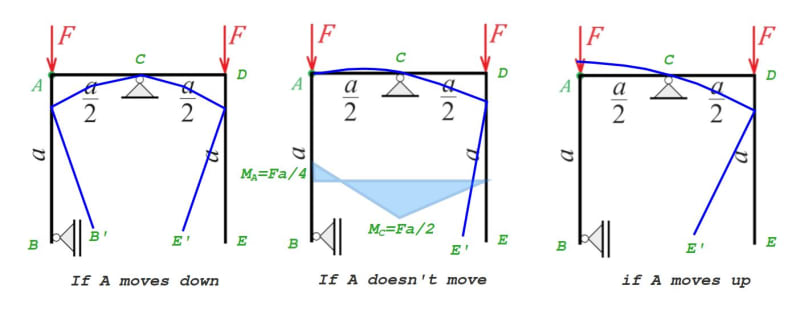

If column weights are neglected, then:
[ul]
[li]If A moves down, B would need to move to B', which is prevented by the roller support at B.[/li]
[/ul]
[ul]
[li]If A stays where it is, the sum of moments on Beam AC requires a reaction at A greater than F, so it must move up.[/li]
[/ul]
[ul]
[li]If A moves up, rotation at A is zero. The c.g. of column DE has moved toward C, but column weight has been neglected.[/li]
[/ul][pre][/pre]
