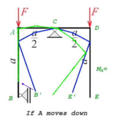

Hi, everyone!
Here is an interesting and funny statics problem, to exercise engineering brains and cheer up.
Given the following structure can you tell, without calculating, in which direction point A will move after deformation:
A) up
B) down
C) will not move
... and why? Point A is not a hinge. No structural analysis programs allowed. 😜
I think it's the same deflected shape? The way I'm seeing it, the deflected shape is the horseshoe shape. The roller simply rotates that shape clockwise by a small amount, which raises B in the process. Like this:
I just realized it's trick question. The title states this is a statics problem. In a statics problem, nothing moves, so the correct answer is C. The original shape is the shape with the loads already applied.

In ""reality"", what's happening is that there is a temporary reaction that rotates the system until there is no longer a reaction. That's my interpretation at least and makes the most intuitive sense.
Why yes, I do in fact have no idea what I'm talking about
BAretired, this is a good approach to compare the three cases.
Tomfh, this is a good explanation. Without the roller support at bottom left, the system is in an unstable balance. An infinitely small force is needed to rotate the structure about the fixed support.
Now it makes sense to me - thanks
Yeah - the 'temporary' reaction and time history idea make the most sense. It's important to remember that all of our deflected shape sketches are grossly over-exaggerated. If they deflected that much, then the deflections would be enough that the forces would no longer be truly equidistant from the center support and there would be a secondary net moment resulting in a real reaction at the roller.
NedGan76,
I think the problem should state that:
[ol 1]
[li]The members are weightless, and[/li]
[li]As the horizontal member deflects, the horizontal length (in the x direction) is assumed to stay the same.[/li]
[/ol]
If those two conditions aren't met, then I think it's impossible for the horizontal reaction bottom left to be zero.
Assuming the two conditions above are true, I picture a propeller with a couple of weightless legs attached. The propeller can be turned to any angle and it's still stable. So, if it's turned until the left leg happens to be where the support is (directly below point A), that's the solution.
Thanks for such a cool problem to think about. This was really working my limited brain cells.

NedGan76 said:
Please, allow me to kindly disagree with this. In statics, nothing moves as a free body - otherwise it is kinematics.
Allow me to kindly disagree with this. The member has moved as a free body - it has rotated about the top central support.
I stand by my previous post - it is unstable when considering small displacement theory.
Retrograde. I would even more kindly disagree with this either. There are three types of structures:
1. kinematic;
2. statically determinate;
3. statically indeterminate.
This structure above is definitely "2. statically determinate" and it is stable. A body has three DOF's in the plane - 2 translations and 1 rotation. So, you need three restraints that are not colinear to get it fixed. This is satisfied in our case. If you see my previous post, I already solved it by hand and found the respective support reactions. So, it moves due to the deflection of members. It would become unstable, if we take out the bottom sliding support. Then, it will be able to rotate around the top support as a free body. Now, it cannot.

"So, you need three restraints that are not colinear to get it fixed. This is satisfied in our case"
Is it? There's only a single vertical support and a single horizontal support.
Edit - sorry top one is pinned.
Ignore me. Lots of replies to catch up on.
GeorgeTheCivilEngineer. No, there are two horizontal supports and one vertical. The top middle support provides restraint in two directions: X and Y. Yes, it is pinned. Sorry, lost in translation. Actually, this is very basic stuff. I am a little surprised that we have to discuss that here. :)
