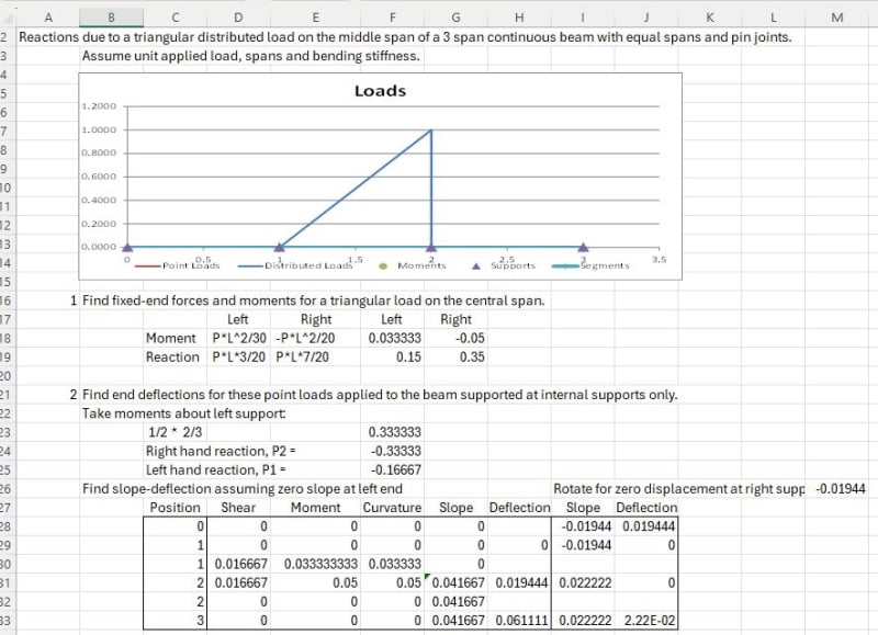

Here are my calculations with the end supports removed to get a determinate structure, then apply a unit load to the left hand end to find the end reactions required to bring the deflections back to zero:
Results are (of course!) exactly the same as before.

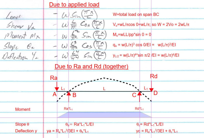

Hopefully this will explain what I have done. Let me know if there are any questions.

I worked through the information contained in your most recent post and have attached your diagram with my notes. I used your equation for theta 0 due to Ra and Rb and added q0 from the applied load. Solving for Ra resulted in 1,711 lb. which does not equal the result of 3,214 lb. given to me from the beam deflection software. So I am still missing something.

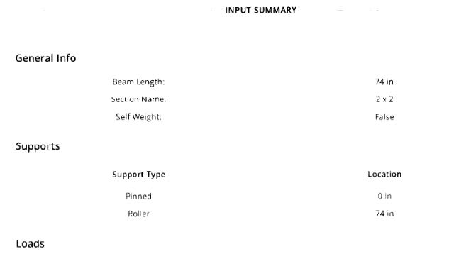

Check the input of your software. On the first page, I see the following:
The moment of inertia you gave me earlier was 0.785 which would be correct for a 2" diameter beam. It is not correct for a 2x2 beam. The span B-C was 62", not 74".
Check all of the input data! That should have been the first thing you did!

I noticed that and thought something was amiss but checking page 5 a 2" round cross section is shown.

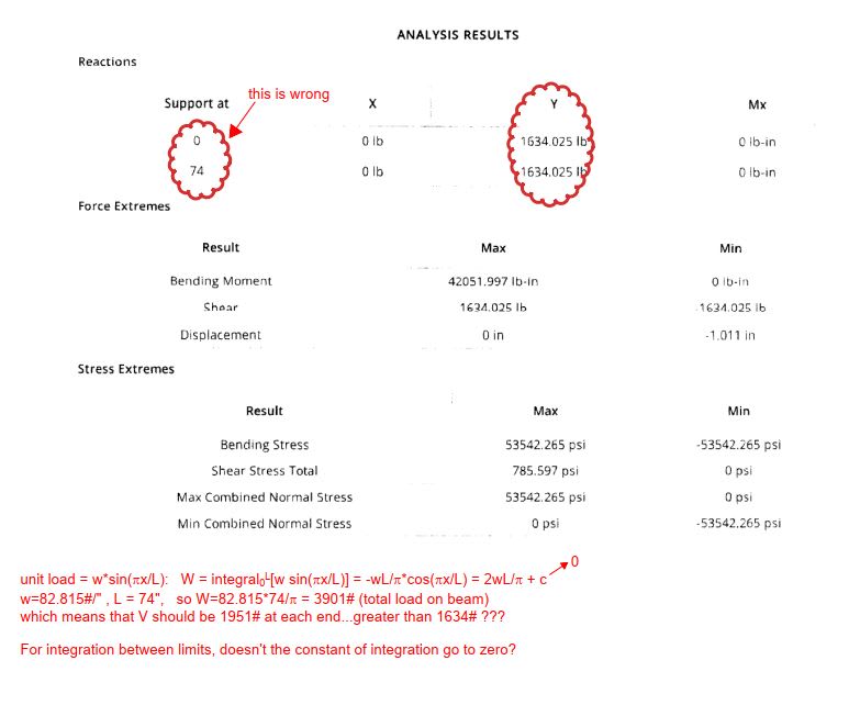

Some Observations:
1. Your derivations for a sinusoidal load are all missing the integration constants which would be solved by applying the relevant boundary conditions.
2. I can vouch for the SkyCiv analysis being correct for the inputs noted in the printed software output.
3. Is your "beam" in fact a hollow pipe? If so that invalidates the skyciv analysis as it used a 2" diameter solid section.
4. I believe above you noted that the internal supports you want to act more like springs, you'll need some way to come up with a spring stiffness to use in the software. (though reading more into it sounds like it should really be a non-linear spring that approaches rigid after compressing the seals enough)
5. The more I see being added to describe your actual situation the more it feels like you are asking the wrong folks and using the wrong software, this is sounding like something better suited for inventor or adina.

1. Your derivations for a sinusoidal load are all missing the integration constants which would be solved by applying the relevant boundary conditions. Could be. I'm a little rusty on my integration, but I thought all of the constants turned out to be zero.
2. I can vouch for the SkyCiv analysis being correct for the inputs noted in the printed software output. Could be?
3. Is your "beam" in fact a hollow pipe? If so that invalidates the skyciv analysis as it used a 2" diameter solid section. 2" diam. solid bar is correct.
4. I believe above you noted that the internal supports you want to act more like springs, you'll need some way to come up with a spring stiffness to use in the software. (though reading more into it sounds like it should really be a non-linear spring that approaches rigid after compressing the seals enough) Maximum moment is not in agreement even for a simple span, although with 74" span, we are close.
5. The more I see being added to describe your actual situation the more it feels like you are asking the wrong folks and using the wrong software, this is sounding like something better suited for inventor or adina. Could be...I dunno.
If we just consider a single span of 74" (even though that is incorrect), what is wrong with the text below?
BA:
"I'm a little rusty on my integration, but I thought all of the constants turned out to be zero."
you are correct I did not download the earlier PDF and thought the derivation was for the Sin load applied partially to a span not to a full simple span.
