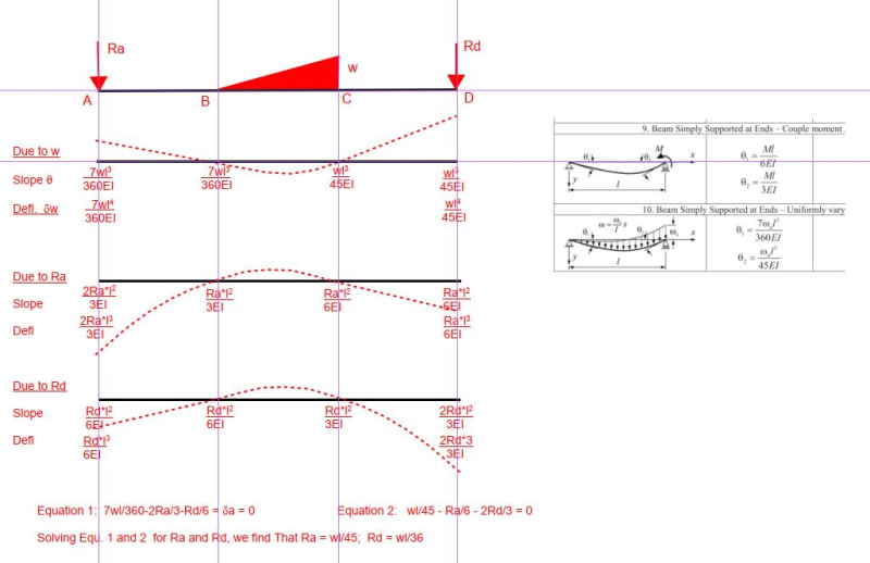

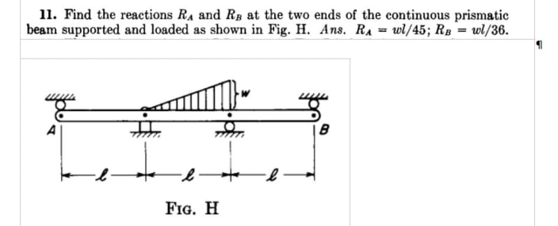

I am trying to solve the following problem which is in the method of superposition section of my Strength of Materials textbook. I am stuck and am wondering if anyone could point me in the right direction.
A beam of length 3L is supported by four supports, A, B, C, and D from left to right. The distance between any two supports is L. Between the two middle supports, B and C is a uniformly varying load with maximum intensity of w. Find reactions Ra and Rd.
I started by eliminating the two redundant reactions at A and D and used Case 10 Simple Beam with Uniformly Varying Load (see attached) to find the slope at points B and C. Then used Case 9 Simply Supported Beam with Couple Moment at End to find the moments a points B and C. From there I have tried many things without success.
The book gives the answer: Ra = wl/45; Rb = wl/36.
If anyone can help with this, I would appreciate it.

This being a textbook question usually they will build on previous problems so if you just jump in at random you’ll be missing the previous works the authors planned for. In my experience for a problem like this there was probably an earlier problem asking for the deflection at a point of a single span beam with triangular load in the span (likely this was in the double integration chapter).
If your jumping in as someone out of school for a refresh then you should already have the knowledge to generate the functions for the deflections.
The approach of removing the two end supports and looking at it as two cantilevers should give the same answer but maybe a bit more work compared to removing the interior supports with the book keeping of tracking through joint slopes and deflection on opposite ends.

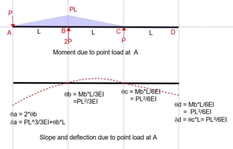

"The approach of removing the two end supports and looking at it as two cantilevers" ... that will give the wrong answer as it assumes zero slope at the interior supports, and I don't think you need to keep track of the end slopes (since nothing is constraining the end slopes (the way that the simple support constrains the end deflection).
you can remove the two end simple supports (instead of the two interior supports, which gives a simple beam problem). and now the determinate solution is a beam with two overhangs. A simplification you gain with this assumption is the the end deflections are due to the slope of the overhand ... deflection_A = slope_B * L; and the unit loads are simplified by symmetry ... deflection A due to load at D = deflection of D due to a load at A, deflection at D due to a load at D = deflection at A due to a load at A.
Maybe another simplification is ... the slope at the supports (B and C) is indpendent of the overhangs. But to determine the slopes at the supports you need to work through the full solution (ie calc displacements) since (I think) the boundary conditions (to solve the integration) at displacement and not restriction on slope; unless you have a worked answer from a text.
"Wir hoffen, dass dieses Mal alles gut gehen wird!"
It does not assume zero slope at B and C. Look at my sketch for the effect of point load at A. It is a perfectly valid way to analyze the problem.

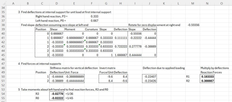

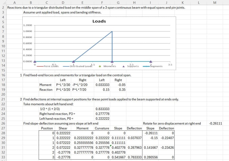

The main point of my previous post was that it simplifies the analysis to do the calculations assuming a unit maximum load, unit span, and unit flexural stiffness. You can then do the calculation with a beam analysis spreadsheet, an FEA program, a pen and paper and slide rule, or anything in between.
I have attached screenshots of a "hand-calculation" on a spreadsheet, and also attached the spreadsheet file. The method used is essentially as suggested by Celt83, which is also used in my Conbeam spreadsheet, which is what I used for my previous calculations.
I agree that it is worth learning the basic principles of beam bending, and how these are combined to calculate beam actions and deflections, from simple beams through to complex structures. I also think that setting up these calculations in spreadsheets is both a great way to learn, and useful for real applications.
Here are the calcs:

Below is a hand calculation using the approach of the OP, who seems to have abandoned the ship.

WoW .. that explains a lot ... I had misread the initial problem as 4 simple supports (like the question being asked now) ... so go back to my posts ... a "simple" doubly redundant beam.
I'm surprised that the solutions provided work if the inner supports are fixed. I'd thought that meant 4 redundancies ... but I can see that the fixed supports "isolate" spans of the beam to simplify the outer spans as propped cantilevers (2 redundancies); but then we haven't solved the middle span (another 2 redundancies),
