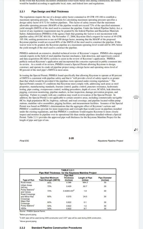

I have yet to find documents for the old Keystone. XL keeps popping up.
This is for the XL pipeline, but the design would be similar. See Ch 2.1 and 2.2
Interestingly a provision is mentioned concerning a pressure of 1308 psig at pump discharge, requiring 0.467" wt (DF=0.72), yet the PHMSA Preliminary Report mentions 1440 psig (0.465" wt@ 80%).
Apparently up to 1600 psig would be allowed at low points, where 0.572" wt would be used (DF=0.72), or 0.515" wt 0.80 DF.

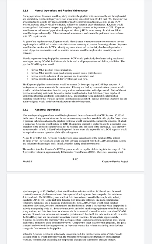

I found the Keystone Phase 1 ES.
Note this is a 30" diameter, mainline size, used for the route from Canada to Steele, Nebraska. The 36" diameter begins south of Steele. The wall thicknesses in the box need to be proportioned to the 36" size by multiplying by 36/30, or 6/5.
Emergency response 140min detection time to alarm with a 9 minute shutdown,
It takes 140m for the pressure to be affected enough for the transducer to pick it up as a pressure loss caused by suspected leakage. As this says, the minimum detectable leak is around 25,000 gal. The pipeline lost 14,000 barrels, so that failed rather spactularly.
