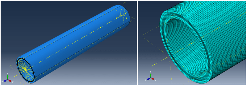

I have been stuck for a while with FEA of a thick-walled pipe (Ri=76mm; t=24mm) under pure bending. The pipe consists of different layers: isotropic and orthotropic. The pipe is a single 3D part layered by appropriate partitioning (i.e. layers assumed perfectly bonded), as I have done successfully in previous models of the same pipe under pressure and tension. I am interested in obtaining through-thickness cylindrical stresses such that I can validate the model against an analytical solution developed on MATLAB. FYI, I will eventually extend the model to include a coupled temp.-disp. step for thermomechanical analysis following validation of the pure bending case. So far I achieve good agreement for axial stresses through the thickness (XY data plotted through path). The (smaller) radial and hoop stresses are in the correct ball park, but more erratic and not correct.
As I understand is typical, I have created reference points at the centre of each pipe end onto which rotation is applied as a boundary condition in a static general step. The reference points are then coupled to the end faces via kinematic couplings.

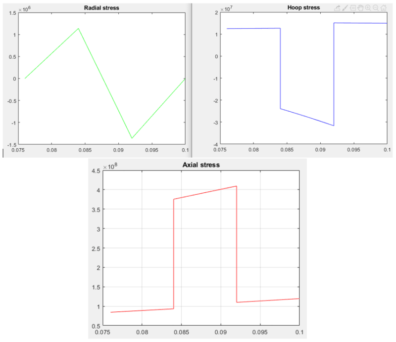

The analytical solution was developed on MATLAB in a study ( subscription required) and modified to the case of my pipe, here. The MATLAB solution is sound, and I can achieve reasonable correlation with FE for axial stress.
FE radial and hoop stresses are of the same order of magnitude as the MATLAB, however more erratic and not resembling the distribution. I would always expect the FE to vary somewhat but at least resemble the through-thickness distribution, if all is well and done.
Please see general images of pipe model and mesh. Rotation is applied around x. I have also uploaded some target stresses obtained using the MATLAB.

I had a look at your model. The boundary conditions seem correct. But to test different element types and mesh sizes I need the .cae file. Could you share it ? If it’s too big to attach here try File —> Compress MDB. Or provide URL for download from hosting service.
Just to make sure that you measure the stresses properly - you transform them to cylindrical coordinate system first, right ?

Yes, I have been transforming into a cylindrical csys for the stresses. I have also tried various combinations of RP boundary conditions/end couplings in cylindrical coordinates, e.g. to allow radial displacement of the ends. However, this does not alter the results significantly and the current constraints are required to keep ends plane upon rotated. Please note this is assumed to be a section of an infinitely long pipe in theory.
Based on the information I got from you and from your model’s files, I think that we can assume that there’s no error in the model. If the results mostly differ at layer interfaces and at free surfaces of the model then probably the discrepancy is caused by limitations of this approach where layers are modeled with homogenous section solid elements. Thus I think that you should focus on testing different element types. You can use composite section solids but stacked continuum shells are an option too. Shell elements may seem like a bad idea in this case where you are interested in through-thickness stress distribution but it’s very likely that they will actually prove better than solids.
