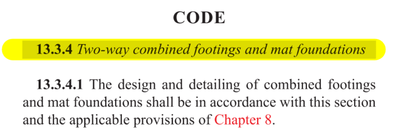

Per ACI 318-19, what is the difference between a "Combined Footing" per section 13.3.2 for 'One Way Shallow Foundations', versus a "Two-way combined footing" per section 13.3.4
The design provisions for one-way shallow foundations lead the user to Chapter 7 for one-way slab, which will require shrinkage and temperature reinforcing in the 90° direction.
However, Two-way combined footings send the user to Chapter 8, for the design of two way slabs, which does not have a minimum for shrinkage and temperature. I'm assuming here you don't have shrinkage reinforcing because you need to provide Asmin in each primary direction. (Which cannot be split between two faces anymore)

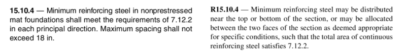

Yep, I understand the reason why we use reinforcing. I was referring to this section of ACI 318-11 that I know a lot of us were relying on to keep the reinforcing down.
I'm saying if that clause was used to halve the area of minimum flexural reinforcement in the tension face, then that use was wrong, and it's a good thing the code has been amended.

Have you done many footings that are governed by overall stability and not strength equations? This creates a huge demand by requiring that 0.0018Ag be applied in full at a tensile face. Some of these footing use and incredible amount of concrete.
It was my previous understanding that, as long as you satisfied the As >4/3 As(required by analysis) you could forgo the need to use that 0.0018Ag at one face only, and thus be able to distribute it at each face. It would meet the shrinkage and temperature provisions of ACI 318-11 7.12.2.1 and allow you to cut down costs.
I think what this is saying now is, it doesn't matter if your As is 4/3 greater than what is required by analysis, You have to use 0.0018 at one face only. And if you have any uplift forces that govern, you might be talking about 0.0018Ag at each face of the footing (not entirely sure about the last statement).
[highlight #FCE94F]I agree that all tensile faces must satisfy their minimum requirements[/highlight] and it would make sense that if you're providing 33% more than required, you should be good.
StrEng007 - I should mention that I don't use ACI 318 in my design work, but if As > 4/3As(required by analysis), then surely that is the minimum As that is required to be placed at the tension face.

Yeah and that's the discrepancy that I'm talking about. The way the new Code is worded, you cannot use the 'required by analysis' steel even if it meets that 4/3. You get stuck with have to use .0018Ag at the face experiencing tension. So much steel!
Disclaimer: this also took place in the ACI 318-14 but somehow I missed that.
So this now goes back to my OP. Is the intent of one-way shallow foundations to apply BOTH the rules of Chapter 7 and Chapter 9 to strip footings and combined footings. Based on the new Code, only the 4/3 rule applies under the section for beams. I cannot see how the beam section should govern the strip or combined footing section. My understanding is the reference to the beam chapter would ONLY be for grade beams.
IF we're allowed to apply the Chapter 9 beam rules to that of a combined footing or strip footing, then I could see the allowance to split that S&T steel at two faces.
It looks like this 4/3As rule DOES NOT APPLY to two-way combined footings/mat foundations, or two-way isolated footings since these section have absolutely no reference to section 9.6.1.3.

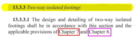

Any ideas why ACI specifies Chapter 8 (Two-way slabs) for the design of 'Two-way combined footings and mat foundations', while both chapters 7 & 8 are specified for design of 'Two-way isolated footings'?
The way I see it, Chapter 8 doesn't make reference to 90° shrinkage & temperature reinforcing. Therefore, I'd assume that each primary direction need to satisfy 0.0018Ag at the tension face. In the event that tension exists at both faces in both directions (for different load combinations) you'd need 0.0018Ag top and bottom, each way, each face. That's a lot of steel!
Chapter 7 is the only one that references 90° shrinkage & temperature reinforcing split between two faces, but I don't see how that would apply for 'Two-way combined footings'. Wouldn't Chapter 8 supersede this?
