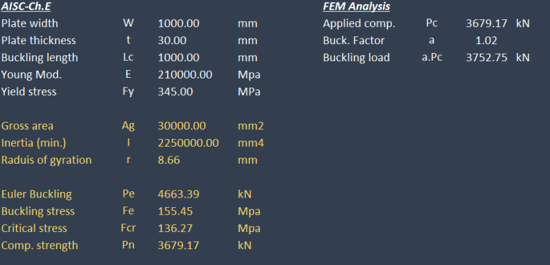

Hello Gents,
When it comes to FEM rigorous buckling analysis using software (say SAP2000 or Etabs), what buckling factor limit would be reasonable. For now i assumed 1/0.9 = 1.11 (0.9 is Phi for compression).
To verify this assumption, i have modeled a plate mesh on SAP2000 (PL 1000x30 mm) with pinned base and lateral restraints at the top. The compressive capacity was calculated based on AISC table 4-22 for kl/r to get Fcr and multiply by Ag, this capacity was applied as compression force on the FE model and carried out buckling analysis which resulted in buckling factor of 1.08 which is somehow near the 1.11. (note that i used non-linear case starting from P-delta and notional load to mimic geometrical imperfections).
As you know, buckling analysis utilize the modulus of elasticity and ignore material yield stress which is not the case when using AISC prescribed formulas. In other words, you will get the same buckling factor for different materials while different capacities will result from the empirical formulas. I have also tried using multi-layered non-linear shell with different materials but still got the same factor.
So my other question is; how can we perform realistic buckling analysis that utilizes material grade in order to verify and set reasonable buckling factor limits for the different types of elements.

SAP2000's linear eigenvalue analysis should give you the elastic buckling stress. That's equivalent to Fe in Section E3, not Fcr like you're getting from Table 3-22 (or 3-14 in the the 16th ed. Manual).
The approach to using SAP2000 for my guess at what you're trying to do:
1. Use eigenvalue buckling analysis to get Fe.
2. If Fy/Fe <= 2.25, then compute Fcr (renamed Fn in 2022) using Eq. E3-2. Otherwise, compute Fn using Eq. E3-3.
3. Compute Pn = Fn * A.
4. Apply the phi factor for LRFD or Omega for ASD to get the available strength.
5. Compare the available strength to the required strength from LRFD or ASD load combinations.

Thanks all for your replies. I believe my thread was not clear.
I have many submittal reviews for shell structures including arched plates, curved metal shell (big logo), sphere like shells .. which are not predefined in AISC and shall be done in FEM. Most of the received design models are mainly addressing the principal stresses and von-mises stress checks along with buckling analysis. Now my argument is if you get buckling factor > 1.0, then the shell will not buckle, but is not necessarily passing the compression limit state as prescribed in AISC.
I did FEM for plate element as per the below shots and established that for high strength material (Gr.50 ksi, or 345 MPa), and did manually per chapter E. When i loaded the FEM plate with compression load equal to the compression capacity, the buckling factor was near to unity which establish that a buckling factor above unity will satisfy code equation. However if used code equation for mild steel this assumption will not be valid anymore.
So my question is how can we use FEM analysis to replace code equations, and what buckling factor shall we consider safe. Note that idea statica software use buckling factor of around 13 which will achieve equivalent l/r <= 25 and thus you can only check yield stress but this will be too conservative.
I have reduce the modulus of elasticity by 20% and used lateral notional loads equal to 0.003 to mimic imperfections (similar approach to DAM since i used k factor of 1.0).
I made iterative analysis considering P-delta and also used non-linear shell in SAP2000 but got matching results for two different materials !
It is also somewhat near 0.99 which suggests that it will buckle spectacularly.
That is an scary assumption. For shell structure like you are talking about I'd be chasing 5.0 rather than 1.1.
And that is a terrible argument and shows you are not fully understanding what is being calculated and the addition complexities of buckling. AKA real world imperfections.
Neither sound suitable unless you have placed the notional loads in exactly the right locations and directions.

The key is to use the correct imperfections and I usually base them on buckling modes. That means that you deform the structure in the worst manner possibly. The next question is how large de imperfections should be. I am not familiar with AISC in this context but the current Eurocode (for steel) has some recommendations, next generation Eurocodes has much more. The purpose of the so called equivalent imperfections is that they shall include the imperfections and the internal stresses from manufacturing.
Once you have your model and have included the imperfections you can make a nonlinear analysis. That means that you do the analysis and include both that the material is nonlinear and that the geometry will deform nonlinear. If you first test to do the analysis without imperfections and then with them you will see a difference. The imperfections will initialize the failure. And then you need to determine what margin of safety you should use.
This was a short description on how this can be done. Using the buckling factor for safety assumptions, I would say that is not advisable.

Thanks all for your input but i still believe that i am far from reaching reasonable approach and acceptance criteria.
FOX89 said:
Now the buckling load from FEM is very near the Euler buckling load which does make sense if we have column element.
The terminology may differ a bit depending on the software. I work with all-purpose FEM-software and "Linear Elastic Buckling" is an eigenvalue problem. If you take "Euler buckling" it is the same thing. So, you can test the accuracy of the solver by modelling the basic Euler cases for members. The difference between the results is usually very small. If you have "Roarks Formulas for Stress and Strain" or Timoshenkos "Theory of Elastic Stability" you will find a lot more examples that you can use to check buckling factors and compare to FEM. But you cannot use these results as an allowed load capacity for design purposes.
As you mentioned yourself, the strength of the material is not included. And as others have mentioned, there are also other things not included [smile].
