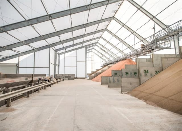

Thanks all for your replies. I believe my thread was not clear.
I have many submittal reviews for shell structures including arched plates, curved metal shell (big logo), sphere like shells .. which are not predefined in AISC and shall be done in FEM. Most of the received design models are mainly addressing the principal stresses and von-mises stress checks along with buckling analysis. Now my argument is if you get buckling factor > 1.0, then the shell will not buckle, but is not necessarily passing the compression limit state as prescribed in AISC.
I did FEM for plate element as per the below shots and established that for high strength material (Gr.50 ksi, or 345 MPa), and did manually per chapter E. When i loaded the FEM plate with compression load equal to the compression capacity, the buckling factor was near to unity which establish that a buckling factor above unity will satisfy code equation. However if used code equation for mild steel this assumption will not be valid anymore.
So my question is how can we use FEM analysis to replace code equations, and what buckling factor shall we consider safe. Note that idea statica software use buckling factor of around 13 which will achieve equivalent l/r <= 25 and thus you can only check yield stress but this will be too conservative.
