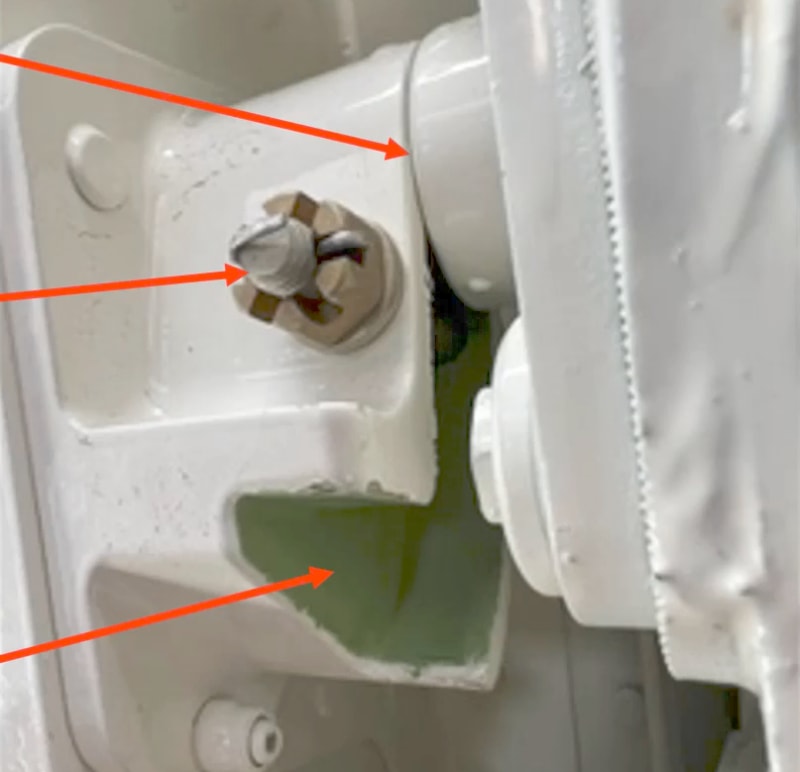

I believe the pin bracket is adjustable, hence the use of bolts rather than rivets to fix it to the fuselage.
So that's:
12 stop pins
2 guide brackets
Maybe 2 hinges
16 points of adjustment at assembly to get one plug to close and seal correctly.
Does the roller guide system have some inherent rattle room?

Thx to Murph 9000's 11 Jan 24 22:31 post I finally understand the whole stop pad / pin thing, I'd now like to get a better understanding of how the pressure seal / gasket arrangement (internal / external) works, especially as related to the up /down, inboard / outboard movement of the door / plug. Must be some not so trivial "wiping" of the gasket. or so I suppose....

I'm starting wonder if the proximate cause was 4 missing bolts (2 in the tracks and 2 through the spring guides). This allowed to door to move upward and depart. The caveat is someone, based on a misunderstanding, overtightened the stop pins to arrest the movement of the door and keep it fixed. After time whatever was in compression around the frame creeped or shifted and the friction between the pin faces and the stop pads diminished to the point the springs could act on the door.
Just an uneducated theory because a cross section drawing of the door is unavailable.

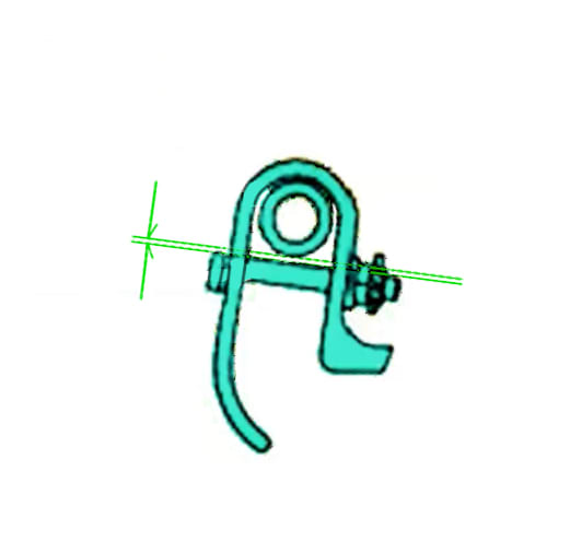

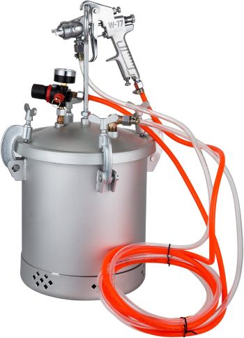

The person may have used paint containers such as this:
These are clamps, not stop pads. Is it plausible someone mistook to door stop pins for clamps when in reality the plug is not meant to be clamped at all?
