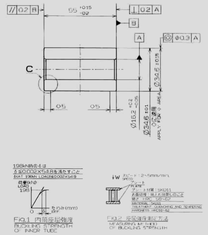

I regularly perform compression tests on aluminum tubing. The tubing must meet a requirement of a minimum length deflection. Whoever drew the print up is using the length (before compression), multiplied by the yield offset value of .002 (0.2%). I'm wondering if anyone knows why an engineer would use this calculation to come up with a max value for the length deflection? My values are always higher as I use a calculator that utilizes "δ = (Pl)/(AE)" which takes into account; the load, modulus of elasticity, length and cross-section area.

According to the Bauschchinger effect, yield stresses induced in one direction (past the elastic limit) lower the yielding strength in the opposite direction.
"does 38kN yield the part ?
yes, because the sample length is shorter after the compression."
sorry, no ... length does not affect stress ... unless you're talking "engineering stress" and accounting for the area change due to volume ... but I don't think you are.
your stress is 37kN/0.1947in2 = 37kN/125.6mm2 = 300MPa = 42ksi ... which is approximately the ftu of 6061T6 !? I would've expected more permanent set in loading something to (almost) it's ultimate strength in compression !

I just went back through 10 random tests from over the last 4 years, with samples having varying areas and lengths, plugged that data into my old calculator that I now know calculates length deformation under load, and the calculator almost always projects a length change of 0.45% So, your .4% is waaaaay off, jk lol.
"Strictly speaking from a calculation, the part shouldn't deform; unfortunately it does."
have we, after a butt-load of posts, come to the problem description ? Do you have pieces failing the test (through "excessive" deformation) ?
I think the problem is with the part print, asking you to apply 37kN to the part, causing a stress of 43ksi, which is above the yield of 6061T6
and then restricting your permanent set to only .2%.

Yeah, that's going to be my fault because I've dealt with the mechanical properties of aluminum forever, but never really looked at them any deeper than if they were in tolerance or not. I apologize for the delays in responses, I just now finished up our 5-day IATF audit, via Zoom no less. Aside from that, I do wish I could spend the time in here and discuss this until I have it figured out, but I'm the quality mgr at a company that provides 4 million lbs of aluminum into the automotive market per month through 150 tier-1 customers so, I get pulled away a lot during the day. I didn't realize anyone was wanting the area, as I've learned from these guys earlier that the calculation I need doesn't involve the part area. My 2nd post described the alloy, temper, shape, and length of what I'm working with.
All of these parts are made in the same process, same extrusion press, same stretching equipment, and aged in the same oven. The only thing I've noticed different between passed and failed tests, is that the wall is thicker on samples that pass compression tests, and not by much, maybe 0.002". If we could just make the wall thicker, we would be golden, but the customer specs the OD and the ID, we don't let customers spec all three dimensions. So for the last year we've been trying to make a tube with the OD at the top of the tolerance and the ID at the bottom, giving us a thicker wall. BUT, this is aluminum extrusion, if I've learned one thing in the last 30 years it's that, if you try to run a dimension at the edge of a tolerance, you will run material out of tolerance at some point during the 1,000s of feet you're extruding. In most cases, a little bit out here and there doesn't hurt, but with the finished part length being an average of 2.5", the customer or the customer's customer finds all of our sins. With the customer's cut length, they are making millions of parts out of our tubes, and when they find even ONE bad part, 1,000s are now considered suspect and have to either be inspected or scrapped.
[ul]
[li]These parts are used in automotive noise, vibration & harshness (NVH) applications, like motor and shock mounts and various brackets.[/li]
[li]Our direct customer only has the responsibility of cutting the longer parts we've shipped down to their customer's cut-length (typically not over 3"). They chamfer the ends, tumble the parts and ship them on.[/li]
[li]The prints that are sent to us are from our customer's customer. Our customer has no engineers, they simply want to know if we can make the part so they can bid on the job with their customer.[/li]
[li]The finished product utilizes two different tubes, both of which we produce; one large OD (up to 4")thin wall tube, the other tube has a small OD with a thick wall (up to 1/2")[/li]
[li]The small OD tube is held inside the large OD tube by vulcanized rubber.[/li]
[li]We make around 35 different OD/wall combinations of each type of tube.[/li]
[li]We perform compression testing on the thick wall parts and expansion testing on the large OD parts.[/li]
[li]Port-hole extrusion dies produce the extrudates at around 1,000f, which are cooled to approx. 120f by water immediately after exiting the extrusion die. The extruded lengths vary, but are generally around 100'. Every extruded piece is stretched an amount that will leave the parts straight and not bowed. The stretching process is the least-controlled process we have, mainly due to the age of the equipment that make it a very manual process where the ends of extrudates are placed into the jaws of immobile equipment (tail-stretcher), with the opposite ends being secured in equipment(head-stretcher)that is moved in reverse to tighten and then stretch the extruded lengths. Dimensions are measured before and after stretching.[/li]
[li]The extrusions are then cut to the final cut-length of 12', placed on racks and artificially aged to T6 temper.[/li]
[li]For parts weighing less than 1 lb/ft, the testing frequency is 1/1,000 lbs. For parts that are heavier, the frequency is 1/1,000'. We collect random samples from the lot of material after aging. Test samples for each compression and tensile tests are sectioned from the same extruded piece.[/li]
[li]For tensile tests, we are simply verifying that yield strength, ultimate tensile strength, and elongation are within tolerance for the alloy/temper.[/li]
[li]For the compression tests, we are ensuring the parts meet the customer print requirement for max longitudinal displacement (almost all customer prints call this a buckling test?)[/li]
[/ul]
I've attached data from a recent print quote. In this one, it actually looks like they are wanting a measurement with the sample under load, but the tolerance they give is entirely unrealistic.
Yes, I think that is the problem. I think I've been blaming the .2% because that's the value that I have to meet, but as I've learned now, that .2% is what it is and cannot be changed. What needs changing is the load value.
This is why I think I'm going to use a calculator that gives me the projected stress which I can simply compare to our historical test results and determine whether to accept or reject the print.
It does not matter what .2% is other than the cusotmer requirement. It does not have to be related to the stress-strain curve, or an offset or anything - it is simply a customer specification expressed as a fraction of the part length. Odd perhaps but then most likely performance based requirements from the regulations that govern their industry.
Aluminum specifications are minimums and it is not unexpected to get more than the minimum sometimes. This may explain your pass/fail ratio.
The customer expects the part to yield or they would not be asking you to measure permenant deformation.
If a part is exposed to a load that exceeds it's yield strength, I'm not sure how you predict, control or limit the deformation.
If you want your parts to have zero failure, design them so the load does not exceed the minimum yield strength. You have done this by experimenting with thicker wall.
If you can't increase the wall thickness, you will need to more closely control the actual yield strength. Since you are the extruder, you may be able to do this with minor changes in the alloying elements while staying within the AA ranges for the alloy.
