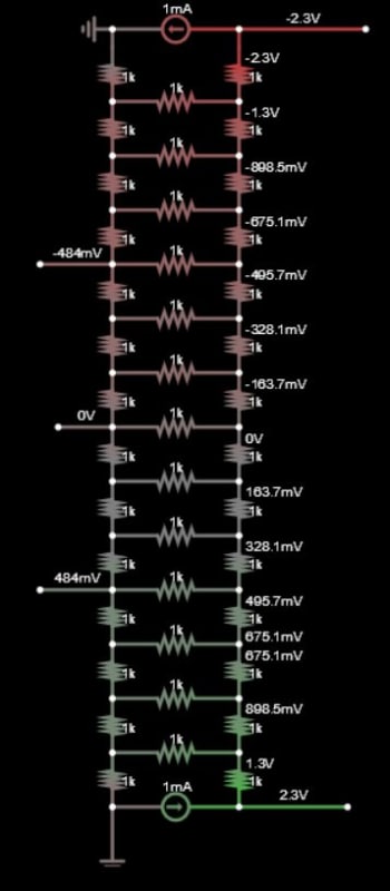

Hiya Sparkies!
I am sure this is going to be a very noob-sounding post, but it's been a few years since my Circuits class...
I have what is essentially a ladder-shaped arrangement of resistors. Each "rung" of the ladder is a resistor, and each segment of the "legs" from rung to rung is also a resistor. I can't disconnect any of the junctions, but I'd like to know the resistance of each segment. I can check the resistance from any junction to any other junction pretty easily, but I know that every measurement I can take is going to end up with a bunch of parallel resistors in the path.
I can't assume symmetry of resistance values on any portion of the ladder, so I am guessing that if my ladder has "n" resistors then I need to take at least "n" measurements, but I don't have a great idea how to set up the measurement points and forumulas/algorithms I should use to do this most efficiently. My fear is that it ends up being a huge system of equations with "n" unknowns, and "n" is in the neigborhood of 30.
The other wrinkle is that I am afraid that variability in my measurements may lead to a system of equations that's un-solvable. The resistance values are (ideally) in the 10s of ohms range. Right now the measurements are taken manually with a DMM, and I can't be entirely sure that if I measure from A to B, then A to C that point A was exactly the same point electrically. At some point I hope to build a jig with multiple probes and switches such that I can take every measurement without moving any probe and just switching the electrical paths. I hope that makes sense... any input or guidance to kick this off in the best direction would be appreciated!

Guarding is the best way on 2 , 4 or more nodes where the average or common-mode signal is driven on the perimeter around the differential measurement. The same method is used on differential instrument amps with low level signals.
You can see by intermediate measurements with a current source , that the voltage or impedance measurements , that the sensitivity is inversely related to the distance from the source.
( ladder simulation on java)
Here I used a differential current source (top and bottom) so you can see the intermediate results with symmetry for now. Any value can be changed or duplicated.

I suspect a "guarded" 2D Kelvin measurement on the surface is appropriate, but we have no idea of the "physical properties".
