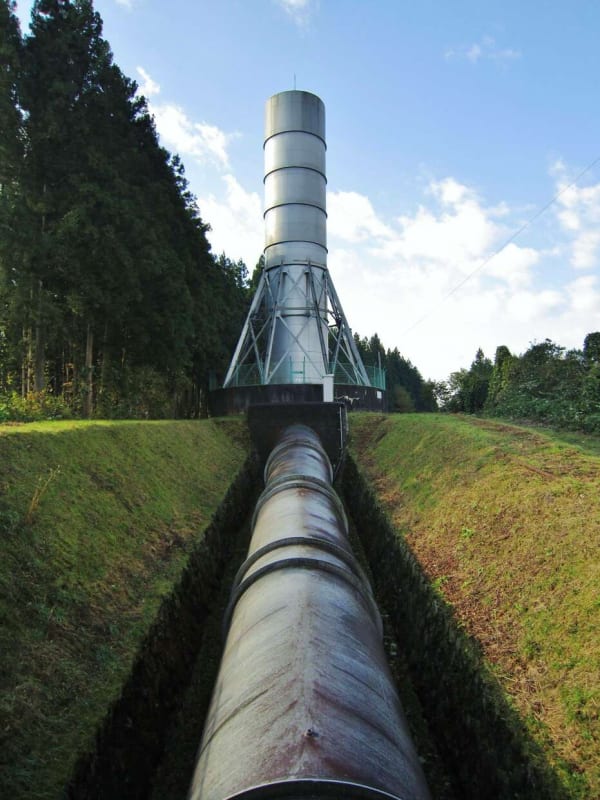

ahardy89 ;
So far, just we know that , you have a steel surge chamber which needs seismic upgrade at high seismic zone with H/D aspect ratio of around two and you calculated the anchors load or chair attachment (130 kips) which is pretty high..
Apparently you are not eager to provide more info. to get the whole picture.. But i think we are free to guess the situation and speculate more for the case.
Let me guess, I suspect that you have calculated the anchor load using the formula Ps = 4MS/(N *Dac) - W′/N which the formula is based on the assumption of elastic distribution of seismic moment on brittle anchor bars ... If the anchor bars ductile ( this is a must ) , the load dist . will be ; Ps = 8MS/(3N *Dac) - W′/N .
I suspect also, the seismic moment calculation is based on max. upsurge water level rather than steady state level. The fluctuation of water that is , time of oscillation last some minutes and max level is experienced for some several seconds.
The following vidoe is useful to get the concept..
Let us assume that your calculation is excellent and you stuck the size of anchors, chairs etc.. Providing more stronger anchors is not only option .. You may think the butressing of surge tank with bracing. The concept shown below;
Dear ahardy89 ; If i were in your shoes , my approach will be;
- Try to learn the operation of surge tank, time of oscillation, the scheme of gates and valves..
- Ask the services of an expert for SEISMIC RISK ASSESMENT REPORT may be from a scholar..
- Perform the analysis based on the findings of SEISMIC RISK ASSESMENT REPORT ,
- If come a cross, look for other options ( ductile design of anchors, bracing from a higher level, perform the calculations as per ASCE 7 , ...)
I would like to remind also, the operation of surge tank can be delayed during a seismic event ( just keeping the steady state operation during a seismic shake) . The motorized gates will serve this condition..
