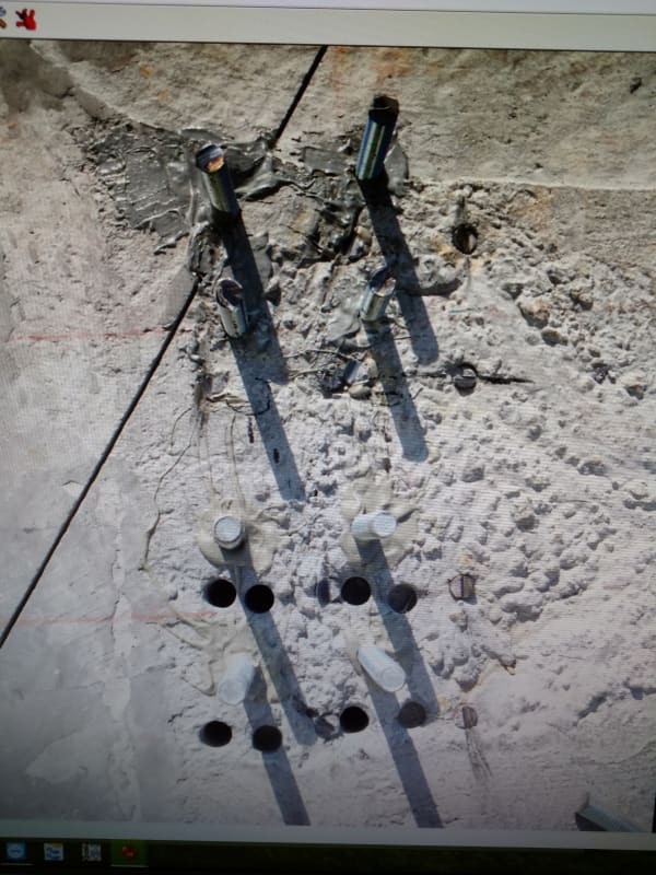

SandwichEngine said:
The only post-installed anchors that get used are for repairs when the concrete contractor messes up the location or projection of the anchor bolts.
Luckily contractors always nail the location on the second, third, fourth, and fifth go-arounds...(sorry about this picture of a computer screen...coworker showed it to me and I had to squirrel it away for show and tell)
