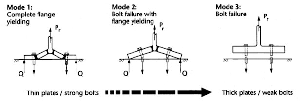

2023-11-13_16_18_41-Why_Prying_Force_is_important__-_Structures-Simplified_pxfxe8.png
If the base plate was flexible enough to cause prying effects due to deformations, then it would look like this.
The tension in the rod would actually be significantly bigger in this case.
This most people will design the base plate to be thick enough to avoid this. A thicker plate is much cheaper than bigger anchors.

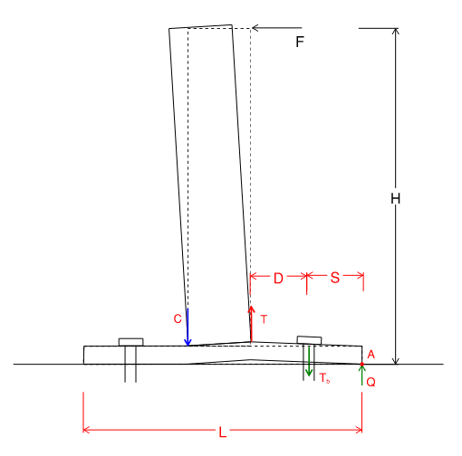

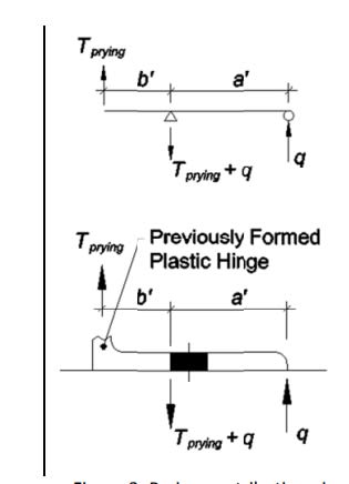

Not at all... I didn't mean to imply that. My program checks for prying action 'all the time'... I built it right in. It also includes prying action for the design of the baseplate, too. AISC has a calculation that if you run it, it stipulates the minimum thickness of the plate that can be used so prying action is not a condition.
the sketches of prying are completely different to the initial one. In dik's sketch "q" is like the useful load "P". In the initial sketch the prying couple is between the bolt and the toe of the flange ... nothing on the load side. Prying doesn't change the maximum bending moment.

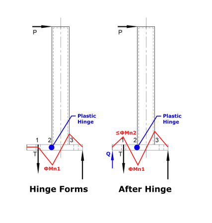

dik said:
They do a little bit at the hole location and increase the moment at 2 a little by increasing T slightly...
T continues to increase after prying action begins, but the moment at 2 does not change. It remains equal to the plastic moment capacity of the base plate, which is the moment that caused the hinge to form and prying to begin. The increased tension does not increase the moment at 2 since it gets offset by the negative moment that now occurs at 1. See the moment diagrams I added to the drawing below:
Structural Engineering Software: Structural Engineering Videos:
Yes, we can all agree that prying action does not affect the magnitude of moment in the horizontal leg in the case I presented. Like I said before, your horizontal leg could be twice as long on either side and moment will still be the same. The only thing that changes is the reaction at the anchor. Prying action is considered only for the connecting elements like bolts and rods. There is no prying check for plates. Prying is a reaction, and in the end there must be equilibrium. Original question has been answered. Feel free to start a new thread called “Prying action discussion”.
