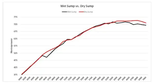

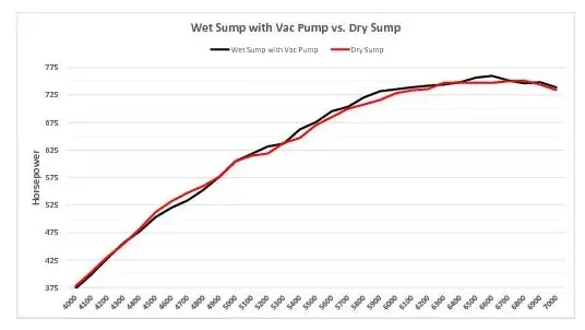

ok here's something I found interesting:
summary:
dry sump small vacuum: 751 peak horsepower
wet sump no vacuum: 741 peak HP
wet sump higher than dry sump vacuum: 760 HP
If you look closely at the graphs you will see the vacuum pump doesn't do much at low RPM, and doesn't so much better than the dry sump except at peak power.
[URL unfurl="true"]https://res.cloudinary.com/engineering-com/image/upload/v1561146230/tips/20-vaccuum-pump-dry-sump-dyno-test-hpr-e1511374419296_shw4dl.webp[/url]
[URL unfurl="true"]https://res.cloudinary.com/engineering-com/image/upload/v1561146237/tips/21-vaccuum-pump-dry-sump-dyno-test-hpr-e1511374468346_n787wq.webp[/url]
