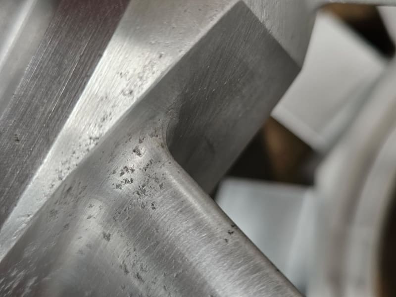

I am looking to get an idea on where the stress concentrations might be. Given the aluminium fans on a particular rotor have undergone excessive corrosion.
As a result of this we are worried about potential cracking around the base of the vanes.
We would typically replace the fans outright on this basis however I am looking to give a bit more of an explanation as to why we would recommend to replace these.

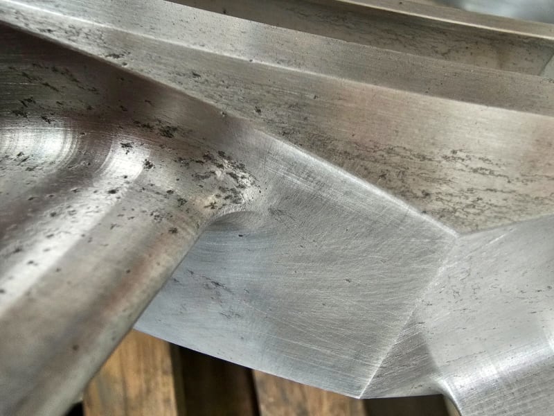

You have stress concentration in an irregular manner due to corrosion. That would seem to make for a difficult analysis.
In many situations like this is setting an inspection period, using dye penetrant inspection to find cracks and then polishing out the corrosion to remove crack initiation sources.
One could suppose that there is a 100% margin and so either replace the part when 30% of the material is removed if centrifugal loads predominate or 20% if bending loads predominate.
If there is a failure before completing an expected inspection period, check the results of the previous to compare to other examples. You may adjust the interval based on the remaining thickness.
Some destructive testing would use some bending cycles on a new fan; since the goal is to break blades you can vary the applied load for each blade on the fan and then repeat this sequence on a corroded fan to see what reduction results.

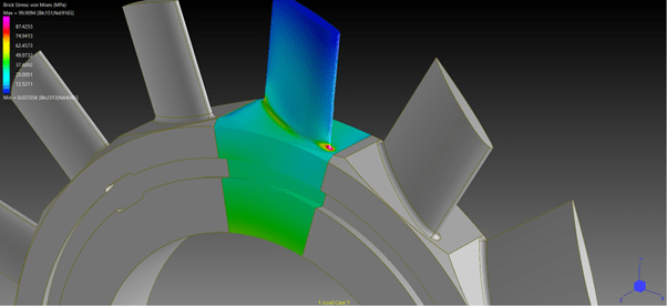

It is difficult. I would like to ask in general - is the centrifugal load the main source of stress in a part like this? (single part fan hub and blades as pictured).
How much of the total stress is due to the actual aerodynamic loads?
I would expect once the force due to lift is accounted for the maximum stress would spead accross the base of the blade of the bottom of the "wing" and the stress on the opposing side would lessen.
Pitting in question:

- Identify areas of significant corrosion pitting
- Compare the stress of the areas where pitting is found to the FEM model - and identify the corrosion sites most likely to compromise the part.
- Identify acceptable material removal without compromising mechanical strength of the part. Difficult as the aero-dynamic loads would appear complex to estimate to a reliable degree without complex CFD or OEM data - likely not within my capability.
Options for repair:
- As you say we could grind back the material to smooth any pitting - focusing on the areas of higher stress as these would be more vulnrable to propagation.
- Replace the fan blades entirely effectively removing all risk of failure due to the corrosion that has taken place. Which would be our prefered option due to obvious risk.

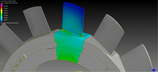

See below stresses from centrifugal force as computed in FEA. I note that I have not included (yet) consideration for the stresses due to the shrink fit on the rotor body.

what mass is the blade? what rpm? how far is it from the shaft? F=m*r*w^2 as you learned in school
aero force is perhaps 1/2*1.1*A*1.2*(w*r)^2 where A is blade width * height, applied 70% up the blade. M/I=sigma/y as you were taught at uni.
so now you can compare bending stresses at the root compared with centrifugal force at the root, and throw your silly colored diagrams away.

By any chance do you know the power draw of this component? If so, you might apply a pressure gradient that follows the function R^2 and has a total magnitude meeting the power draw.
The pressure distribution itself does not need to be perfect, as we already know the stress-limiting locations. You just need to apply an appropriate bending load to the blade.
Getting the drag data will be much harder than the stress analysis you ultimately want to perform, but if you believe the drag is high, you can skip the R^2 and apply a point load at 3/4 of the blade radius and increase/angle the point load vector to include some drag.
You're not going to get any closer to reality than that unless you have a very high end CFD package and appropriate test data to tune the CFD model.
