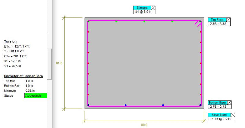

Ok, KootK, I didn't want to assault you all with the details, but as you insist[wink], there you are:
Beam dimensions: 2010 x 1550 mm (width x height)
Concrete: f'c = 25 MPa
Steel: Fy = 400 MPa
Ultimate forces acting on the beam (the complete set, not only torsion), at midspan:
M vertical = +3200 KNm​
M horizontal = +-1630 KNm​
Axial (tension) = 2500 KN​
Torsion = 1100 KNm​
V vertical = 1400 KN​
V horizontal = 400 KN​
Reinforcement schedules (these were my preliminary estimations, previous to all this discussion):
Longitudinal:
Lower face: As,req = 81 cm2 (M+N) + 15 cm2 (T) = 96 cm2 ; As,min = 96 cm2 (M+N) + 27 cm2 (T) = 123 cm2 (-->16#10)​
Upper face: As,req = 17 cm2 (N) + 15 cm2 (T) = 30 cm2 ; As,min = 17 cm2 (N) + 27 cm2 (T) = 44 cm2 (-->6#10)​
Side faces: As,req = 41 cm2 (M+N) + 15 cm2 (T) = 56 cm2 ; As,min = 55 cm2 (N) + 27 cm2 (T) = 82 cm2 (-->11#10)​
(As,min for M+N try to take advantage of clause 9.6.1.3, which basically limits As,min for M to 1.33 x As,req)​
Transverse:
Inner stirrups for vertical shear: As,req = 2 cm2/m; As,min = 16 cm2/m​
External stirrup for torsion: As,req = 10 cm2/m; (Av+2At),min = 17 cm2/m​

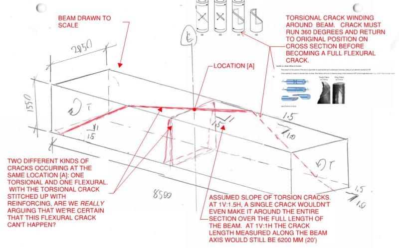

What desperately needs to be acknowledged here, I think, is:
1) That a torsional crack needs to make it around the entire section, 360 degrees, before it becomes a flexural crack and;
2) Just how damn long of a crack #1 is as measured along the axis of the member.
Below, I've shown OP's beam, drawn to scale, with a plausible torsional crack. That crack doesn't even make it once around the beam over the span of the beam. Were I to have drawn the crack at 45 degrees, it still would have taken twenty feet for the crack to run full cycle and open up a full section, flexural crack. At location [A], with the torsion crack stitched up with reinforcing, are you really telling us that you're confident that a flexure crack is not possible?

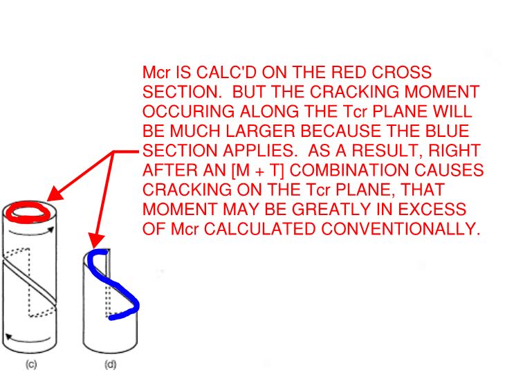

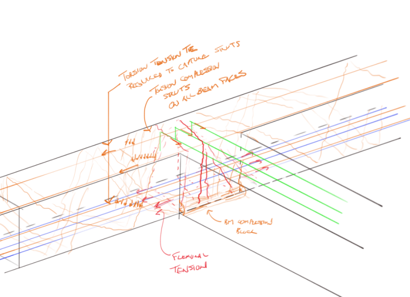

I don't agree. The sketch below shows how I believe that you could arrive at a [T + M] combination that would produce a minimum reinforcing demand in excess of either the flexural min or the torsional min alone. I don't want to get hung up on this, however, given that I consider it a moot point because I'm confident that the torsion and flexural cracks are actually different cracks. My previous post that included the second sketch below contained the bulk of what I consider to be my salient arguments for that theory. Do you not find any of that convincing? The fact that a full section torsional crack runs the full length of the beam here?

No, I don't find your analysis convincing because it appears to rely on double counting of the tensile capacity of the concrete. You're counting the tensile capacity of the concrete once towards flexural crack resistance, and once again towards torsional crack resistance. You are treating the flexural crack resistance and torsional crack resistance as distinct things which can both be loaded to 100% without influencing the other, when in reality they both depend entirely on the same concrete in tension.
Your diagram for example shows a torsion crack on the flexural compression face, but no torsion crack on the tensile flexural face. I'm not denying a flexural crack can't happen, I'm saying it WOULD HAVE ALREADY HAPPENED given that the flexural tensile face is the critical face in terms of combined flexural and torsional tension.
80% cracking flexural moment + 80% cracking torsional moment = 129% of concrete tensile strength if I've done Mohr's circle correctly. 62% of each is equal to the cracking stress. From the 4th post, that gives 0.62*10 bars for flexure and 0.62*11 for torsion = 13 bars as an estimate of minimum consistent with the requirements for pure flexure/torsion.
