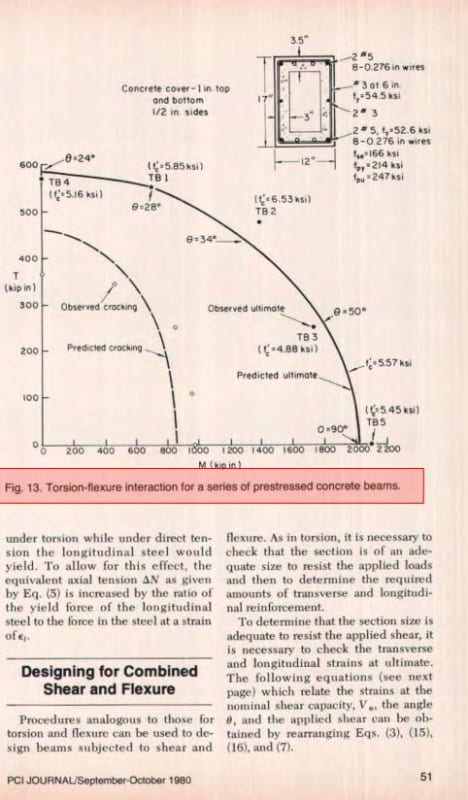

So I had to dig deep but I managed to find a published reference that deals specifically with the combination of the minimum requirements for torsion and flexure. That reference is attached. Below, I've highlighted the bits that I believe are of particular relevance. Some things to note about the reference:
1) I believe that it's public domain.
2) It's crazy old and may well be superseded by other stuff.
3) It's by Michael Collins who is, for all intents and purposes, the Jesus of modern concrete shear design.
4) Per usual with Collins, all of the good stuff flows from the Modified Compression Field Theory of shear.
If one suspends disbelief and takes the Collins reference as gospel, I believe that the following conclusions will be manifest:
A) The minimum requirements for flexure and torsion are indeed additive, at least to a degree.
B) The minimums need not be added at their full, individual values (reference uses "pure" values for this).

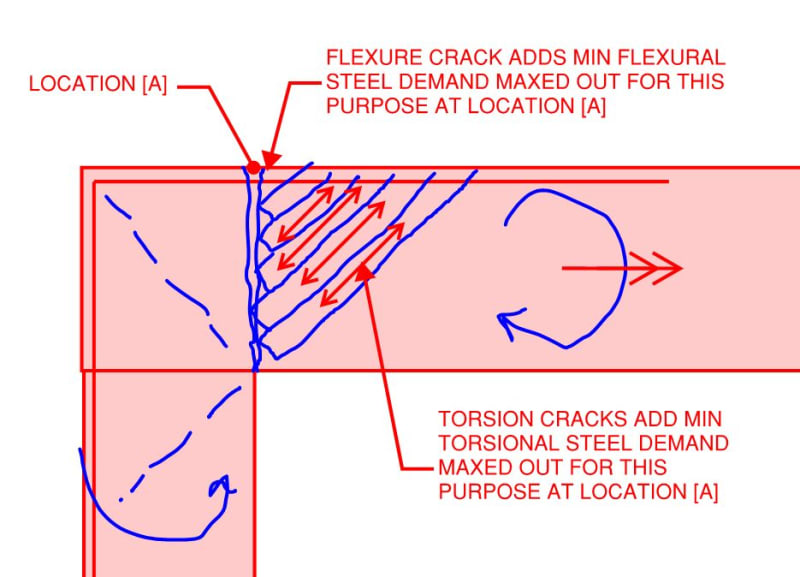

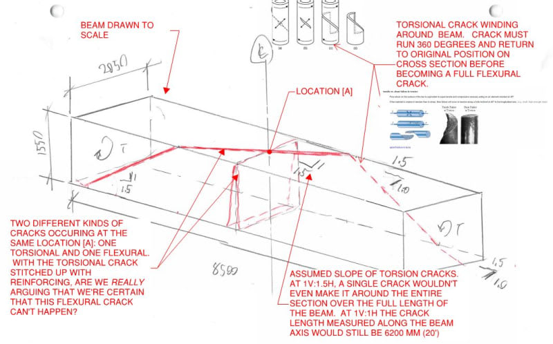

What if the torsion crack is at the bottom of the beam at location A? Would torsion and flexural be addative?
So does the torsional force have a component along the beam axis and perpendicular to the beam axis?
Yes the torsional force has a longitudinal (tension) component, and a transverse tension component. The net result is diagonal tension pattern spiralling around the beam, hence the spiral fracture pattern.
In the example above the beam would actually crack at the bottom, where the flexural tensile force adds to the torsional tensile force. You’d get a combined flexure torsion crack.
