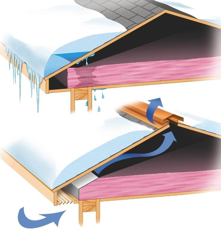

If you do go down the insulation route be really really careful with ventilation especially blocking the eves of roofs. People are getting waterfalls of condensation in the UK after upgrading roof insulation done by clueless cowboys.

Don't you know the necessity of venting the attic space above an insulated ceiling or what happens if you don't?
Ideally all surfaces within the house envelop should be higher than condensation temperatures.
Adding insulation at ceiling level stops the attic from warming via heated areas below. The attic will often cool to condensation temps. Then you have a rain making machine up there.
If you also insulate the underside of the roof, you will retain enough heat in the attic to prevent it falling to condensation temperatures.

There also seems to be loads of confusion over mixing technology so you get sealed warm roofs with gaps between the vapour permeable membrane and the insulation so the vapour condensates on the membrane without getting through it and then runs down the bottom or soaks into the surrounding wood.
Then there are others that block the eves ventilation as detailed in that picture.
Then there is a growing issue with the sprayed foam between the rafters which was all the craze 10 years ago as the roof timbers are now all rotting.
And ventilation seems to be used as a cure instead of a primary part of the design.
