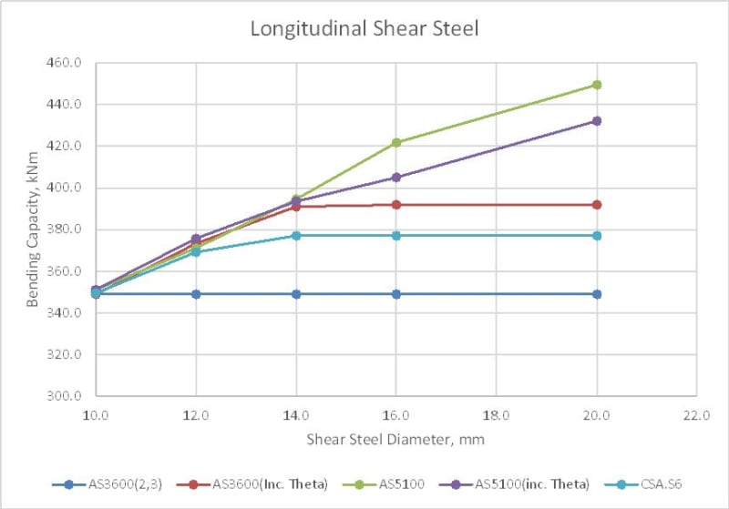

I think it is worth looking at my plot of the moment capacity to different codes:
The top line complies with all the current requirements of AS 5100.5, but if the restriction on Vs was included it would come down to the light blue line (Canadian code). How is that not unconservative?
Although I could not find the reason for the restriction similar to "ΦVus not to be taken greater than V*" in AASHTO and the Canadian standard,
The reason is that the force in the shear steel cannot be more than the applied shear force. But it seems that you agree that AS 5100.5 should be changed anyway.
For AS 3600 I agree that the equation can be over-conservative if applied without adjusting theta, but with adjustment of theta it is less conservative than the Canadian and AASHTO codes, whilst still complying with the requirements of MCFT.
The procedure for adjusting Theta is:
1) Find the angle (and associated strain) such that phi.Vu = V*.
2) If that is greater than 50 degrees then set Theta to 50 degrees and strain to 0.003.
3) Calculate the longitudinal force due to shear with the new Theta.
4) Find the moment capacity allowing for this force.
Note that AS 3600 explicitly allows the longitudinal strain to be increased above the calculated minimum value (Cl. 8.2.4.2.2), up to a maximum of 0.003. The only reason I can think of for doing that is to reduce longitudinal steel forces by taking advantage of available vertical reinforcement capacity, by increasing Theta.
I don't follow your objection to using an interaction diagram. For any point on the line the moment is equal to the section moment capacity with the associated applied shear force. Any point inside the line will have a greater shear and bending capacity than the applied actions.

(1) Are all your plotted points optimally adequate for section shear (i.e having V*=φVu) ?
No, the whole point of the exercise is to investigate the effect of increasing the area of shear steel so that V* < φVu. When V*=φVu the AS 3600 and AS 5100 equations give the same result.
(2) In your procedure for adjusting theta, you mentioned about getting theta greater than 50 degrees for φVu = V*. How is it possible to get theta > 50 degrees when the standards do not allow εx to be larger than 3E-3 in the calculation of φVu ?
No, εx can vary between the minimum value given by the equations and 0.003, as stated in the code, so the maximum value of Theta is 50 degrees. That is why the moment capacity line using AS3600 + adjustment of Theta flattens out at 14 mm in the graph plotted in my previous post, but the AS 5100 lines continue to increase.
(3) Does any of you points satisfy optimal adequacy for both block rotation (fs = fsy) and section shear V*=φVu ?
Aa above, we are looking at the cases where AS 5100 gives unconservative results for bending when the shear steel has been increased so that V* < φVu, but for a shear steel diameter of 10 mm V*=φVu and all the codes give the same result.

If I can see the values for the listed variables below for the first two points of the AS 5100.5 line, that will help me to understand better your study.
I'll have a look and either post the values or the complete spreadsheet.
Doug Jenkins
Interactive Design Services
Doug,
Considering more than 1 mode together is confusing when using an interaction diagram. I therefore limit my discussion below to section shear effect.
Say, for the solution for point 2, you use an interaction diagram for A_sv2/s. And you iterate along the line from the origin of the diagram maintaining the relation M*/V* for the point (V1*,M1*), and this line intersects with the interaction diagram. Say, the values you get from the intersection point are M*_intersect,V*_intersect and phiVu_intersect. M*_intersect is not a "reduced moment capacity" of (V1*,M1*). It is the coexisting design moment with design shear of V*_intersect, and for these effects, the ultimate shear capacity is phiVu_intersect.
Before you spend more time on this, I better check with you whether the above steps were used to get point 2 since you mentioned M*/V*. If you did, the coexisting moment (your "moment capacity") you get for point 2 is for a different design shear, not for V1*.
I mentioned M*/V* with respect to creating an interaction diagram, where iteration is required.
For checking a section for a specified V* and M* the procedure is:
1) Find the mid-height strain for V* and M* and then find the associated Phi.Vu.
2) If Phi.Vu < V* then the section doesn't work.
3) If Phi.Vu > V* then find the mid-height strain such that Phi.Vu = V*, and the associated adjusted Theta.
4) Using the lesser of the adjusted Theta or 50 degrees, find the section Phi.Mu, including allowance for longitudinal load due to shear.
5) If Phi.Mu >= M* the section is OK. If it isn't the section doesn't work.
6) Finished.
I don't know what you mean by "iterate along the line from the origin". If I create an interaction diagram I then plot all the M*, V* points, and those inside the line are OK, those outside are not.
Doug Jenkins
Doug,
In your step 3, you have to assume a relation between M* and V* to be able to get V* = phiVu. I think you used the ratio of M*/V*. At the end of this step, the design shear is same as the ultimate shear strength V*_intersect = phiVu_intersect. The design moment is
M*_intersect = M*/V* x V*_intersect. This adjustment is what I mean by "iterate along the line from the origin". At the end of the adjustment, M* and V* are on the interaction line.
My understanding of MCFT and the use of AS 5100 for design of your point 1 and 2 AS5100case is :
When you increase the shear reinforcement from Asv1 to Asv2, for a set of design actions (M*,V*),.
For 2
Bending capacity phiMu no change from 1 since no change in Ast.
Shear capacity phiVu increases as a result of the increase of shear reinforcement from N10 to N12
phiVuc and theta_v - no change since they depend on M*, V* and Ast only, not Asv.
phiVus increases owing to the increase in Asv from Asv1 to Asv2
MCFT is a theory for shear capacity, and this capacity is determined using the applied action effects (not factored up [or down] action effects), so no iteration (adjustment of strain to give V*=phiVu) is required. The theory cannot determine bending capacity.
I reproduced below a block of text from one of my earlier posting (with correction) to illustrate this:
"There is no single "actual shear capacity" for a section, even for a test structure with an increasing test load. For a test structure with a monotonically increasing applied load Pi such that both Mni and Vni increase with the load, at any stage (say i) of loading, the shear strength Vnui can be determined. To check experimentally the accuracy of the equation used for MCFT, one has to iterate (numerically) to predict the load for Pui when the shear Vni where Vuni=Vni. Note that this iteration uses the characteristic of the loading, i.e. Mni/Vni is assume constant. This strength Vni=Vuni is not the actual shear strength of the section:It is the shear capacity of the section only for the level of loading where the action effects are Vni (where Vni=Vuni) and the coexisting Mni."
The subscript "n" indicates nominal or unfactored.
For design (and for load rating of a rating vehicle),and for a section with M* and V*, the only ultimate shear capacity of relevance is the phiVu determined without iteration. The action effects are factored up. So if V* < phiVu, section-shear is adequate.
No, that is not the procedure I am following. The graph of Moment Capacity against bar diameter shows the design moment capacity (Phi.Mu) for a specified and unchanging V*. That is why all the lines other than AS 5100.5 flatten out when phi.Vu with Theta = 50 degrees > V*.
For generating an interaction diagram you need to iterate to find each point on the line but having done that you just plot each load point from the analysis using M* and V*, which seems to be entirely consistent with your final statement:
... subject to M* < phiMU of course.
So given that we agree on that, I have no idea what your point is.
Doug Jenkins
