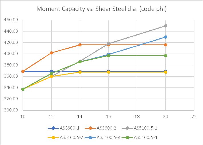

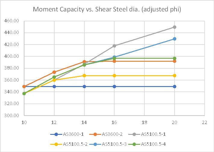

kww2008 - You are still ignoring the big problem with the AS5100.5 equation, it has no limit on φVus, whereas all the N. American codes using the same equation do have a limit.
I have updated the graphs I posted previously to compare AS3600 with AS5100.5, with and without the limit. In the graphs below the loadcases are:
AS3600-1: Longitudinal force due to shear to AS 3600 with Theta values set to minimum.
AS3600-2: As above with Theta adjusted so that shear capacity = applied shear, up to a maximum of 50 degrees.
AS5100-1: Longitudinal force due to shear to AS 5100.5, with Theta set to minimum value and no limit on Vus.
AS 5100-2: As above but phi.Vus set with a maximum value of V*.
AS 5100-3: As ASS5100-1, but with Theta adjusted.
AS5100-4: As AS5100-2 with Theta adjusted.
With AS3600 reduction factors applied to both codes:
With applicable code reduction factors applied to both codes:
More details at:
In summary, if the limit on φVus is applied with the current code reduction factors then, at least for this one case, AS 5100.5 results are always equal to or less than AS3600, but if it is not applied they can be unconservative.
How this will change in the next amendment of AS5100.5 I don't know, but in the draft for public comment there was no change to the equation proposed.
Doug Jenkins
Interactive Design Services

The AS5100.5 committee has been told the errors in their shear rules many times over the last about 7 years since the first release with MCFT.

kww2008 - Thankyou for the additional results. The results for M* = 400 kNm are broadly in agreement with mine, and show why using the AS 5100.5 equation with no limit to Vus is unconservative compared with both AS 3600 and the Canadian and AASHTO codes.
Firstly, when I say that a procedure is "conservative" in this discussion I mean that it will return section design capacity results no greater than those found using a more refined procedure, or other widely accepted procedures. I am not sure what you mean when you use that word.
Looking at the results with an M* of 400 kNm you agree that the current AS 5100.5 procedure indicates that the section with 20 mm shear steel is satisfactory for this applied moment, with a shear force of 275 kN, whereas the Canadian and AASHTO codes and AS 3600 indicate that it is not.
The current AS 5100.5 procedure is therefore not conservative.
