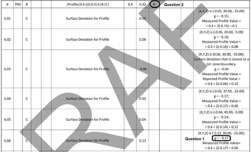

Please ref to Figure 9-4 as shown below, I am confused on how to get the data of g = - 0.17. Thanks for anyone who can give me a light here.

Season
SeasonLee,
I checked the calculation, and the numbers are incorrect in that cell in the table. The g value should have been -0.13, and the measured profile value should have been 0.14.
Thanks for pointing this out. I'll check the latest draft to make sure it was corrected.

Thank you SeasonLee and Evan,
With many eyes reviewing the Y14.45 draft, no one had noticed that error yet. Thank you. This item in Fig 9-4 has been fixed now in the draft. The next public review should be occurring during the month of December. I hope the standard will be released sometime around mid-2021, but that will depend upon ASME's processes for getting the draft published.

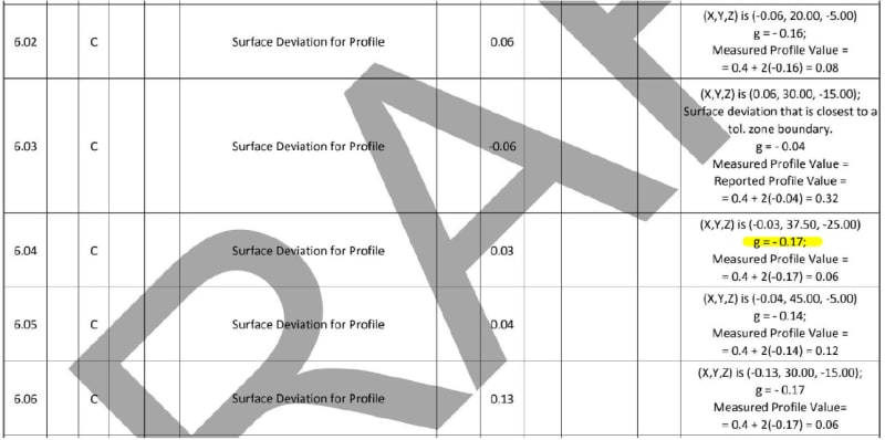

Further two more questions I have while on my understanding how to write the profile measuring report:
1. From the same logic, I cannot figure out how to get this g value -0.17 as shown below.
2. The reported value 0.32 is within the tolerance zone boundary, why reject this part?
Thanks in advance for the help.
Season
SeasonLee,
I would assume that the rejection of the surface profile characteristic is due to the unequally disposed tolerance zone. A deviation of 0.3 is allowed in the external direction, yet 0.32 was measured.
SeasonLee,
1. The g value is based on the proximity of the measured point to the tolerance zone boundaries, and this gets more complicated with unequally disposed profile tolerances like the one in Figure 9-4. The specification is 0.4 (U) 0.3, which means that the MMB is at +0.3 from the true profile and the LMB is at -0.1 from the true profile. The deviation of the measured point from the true profile in 6.06 is 0.13. So the point is (0.3 - 0.13 = 0.17) inside the MMB which would give a g value of -0.17. The measured point is (-0.1 + 0.13 = 0.23) inside the LMB, which would give a g value of -0.23. The g value for the measured point is based on the "worst" condition relative to a tolerance zone boundary. In this case, the measured point is closer to being out of tolerance relative to the MMB so the g value corresponding to that boundary (-0.17) is used. Another way of expressing this is that the larger of the two g values should be reported. In this case, it's the one that is less negative.
2. The N indicating that the tolerance is not accepted was incorrect in the public review draft - it should have been Y. This error has since been corrected. You're correct that a reported value of 0.32 for a profile tolerance of 0.4 should be conforming.

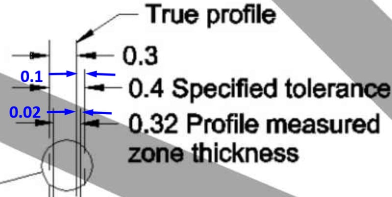

I think you are right, but can we think that .002 is also within the 0.1 tolerance zone as shown below.
Regarding the g value, I will assume -0.17 = .030 - .013, am I right?
Season
