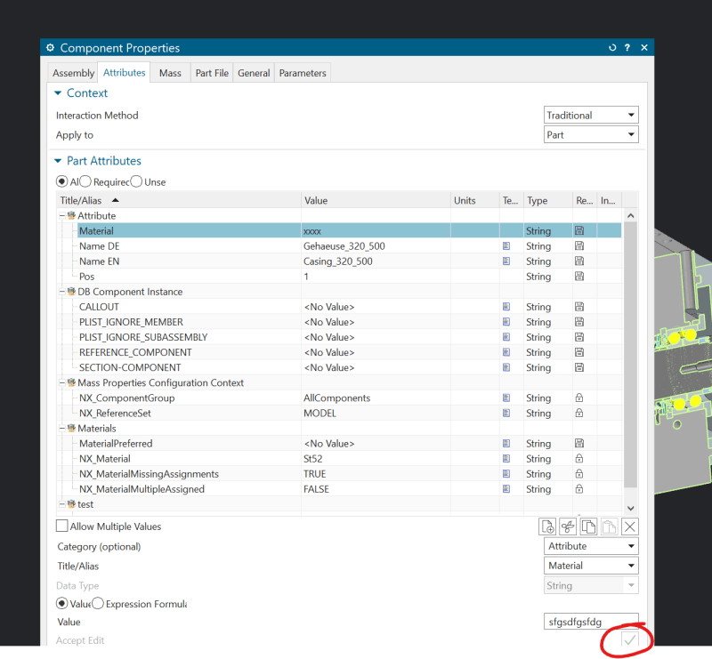

Hello,
i have used a self created template. But now I cant change the attribute.
Please see my video:
And as you can see in the screenshot i cant tick the green check button..
I hope someone can help.
Thank you
Martin
The default setting when you install NX is that the option that Gelsonnicoletto mentioned :
"Under customer defaults > Gateway > materials/mass - Part attributes", is set.
This will , when you assign a material using the NX material library , also create the attribute with the name that can be set under the same customer defaults.
Once set, this attribute can ONLY be changed from the Assign Materials dialog-s because it is linked both to the material which is applied/assigned to the solid body and also the material table.
It is not "just a simple attribute" because of these links.
If you want an "attribute only" which is not associated to the specific body, nor connected to material properties, you probably need to name this attribute "My_material" or something similar, or you change the customer defaults to use a different name.
