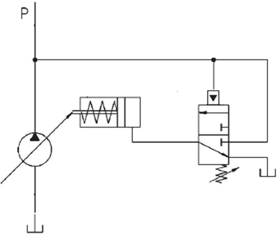

I have a small eaton-vickers pump that looks almost like this only mine is green.
It has a 5 HP motor driving a 5 gpm pump at full flow.
We no problems with setting the system pressure at about 1500 psi when there is no flow. We can't adjust it much higher because the 5HP motor is limited.
The pump should provide no flow at 1500 psi.
The question I have is at what pressure do I get full flow?
It seems to me this is a function of the spring. Adjust the spring in and out adjust a proportional band where the flow is proportional to the pressure drop from 1500 psi. However, there is no way to know how far the pressure must drop to get the full 5 gpm from the pump. It seems to me that this would be a function of the spring constant. A stiffer spring would more cause the port to the swash plate to open up more with a smaller pressure drop. This essentially is changing the proportional band of the pump.
Are there specifications for this?
Are there specifications for how fast the swash plate moves?
Is it possible to replace the spring in the compensator?
As a controls person this seems simple but crude.
BTW, know the flow because I can measure the speed of the piston and know the areas of the piston but I am looking for a general case.

Isn't a pump compensator more like a PI than just a P?
That is a good question to think about. It would be nice if it were so but...
I say no for two reasons.
1. There is only a spring. That is for the adjusting the system pressure level. The spring constant determines the proportional band. What would be controlling the integrator?
2. If the pump did have a PI controller the pressure would stay at about the system pressure and there wouldn't be the proportional droop.
Hydtools provided info on the pumps and it is easy to see there is only a proportional gain. The document shows the pressure-flow curve is a quadrilateral with the top part drooping due to efficiency and the right side sloping to the left due to the pressure droop. If there was a an integrator there wouldn't be the pressure droop. The pressure would be pretty constant around the set point until the flow rate varied. When the flow rate varied the pressure would go up or down until the integrator wound up or down compensate for the flow change.

Look at how the pump works inside.
The bias spring (non adjustable) always tries to swivel the pump to max displacement.
When the set pressure is reached the adjustable pressure valve opens allowing oil into the swivel cylinder which swivels the pump back against the bias spring.
This swivel cylinder is the integrator.
The schematics in the datasheet for the PVB5 are a not that clear
On at page 14 in this datasheet there is a fairly good schematic:
Edit: an even simpler theoretical sketch here
The volume of the cylinder that actuates the swash plate adds up the fluid that the pressure control valve is feeding it. That conceptually sounds like integration to me.

I can understand why you think this but you need to understand the difference between integrating and non-integrating systems.
Look at the document hydtools posted. The graph of flow vs pressure shows the flow increases with the pressure drop. This is a simple proportional band. If there was an integrator then the flow would not drop except when the demand makes a sudden increase.
In a hydraulic cylinder the open loop model has no integrator for velocity but there is one for position. Same system so why the difference? It depends on what you are trying to control.
You need to understand the difference between integrating and non-integrating systems. A non-integrating system goes back to ambient or quiescent state when the control signal gone. In a hydraulic system system the velocity drops to zero but the position does not revert back to the original position because position is an integrating process.
Likewise the ambient position for the pump is the spring extended in the diagram Jacc posted. It will not hold the swash plate position when the pressure is gone to oppose the spring.
Trust me on this.
BTW, I got inducted into the IFPS hall of fame for my work in motion and force control and control theory for hydraulic systems and the flow vs pressure plots show that there pressure compensator is a simple proportional band.
Temperature control systems are non-integrating. If the control/power is taken away the cool down or warm up to ambient temperature. Accumulators are integrating systems. They integrate the net flow.
